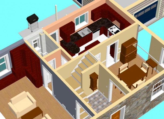

You can do a search of the archives on this site for "Cadd Software" or you can go here and take a look at Home Designer Suite 6.0:
http://www.homedesignersoftware.com/
HD Suite 6.0 (they are up to 6.04 now) is about $100
HD Pro is about $500
Chief Architect is about $1700
All programs have the same user interface. Here is a picture of my kitchen done with the $100 program:

Another alternative, especially if this will be "almost a" one-time use software is to go on ebay and search for 3D Home Architect Deluxe Version 3.0. Accept no substitutes. This was developed by the same people who do Chief Architect and was "distributed"/sold by Broderbund.
You should be able to get this for $15 delivered and you will be amazed by its ease of use and power. The kitchen plan I had originally posted was originally developed using 3D HA Deluxe 3.0 and is just being displayed using the latest version of this software - BH&G Home Designer Suite 6.0.
