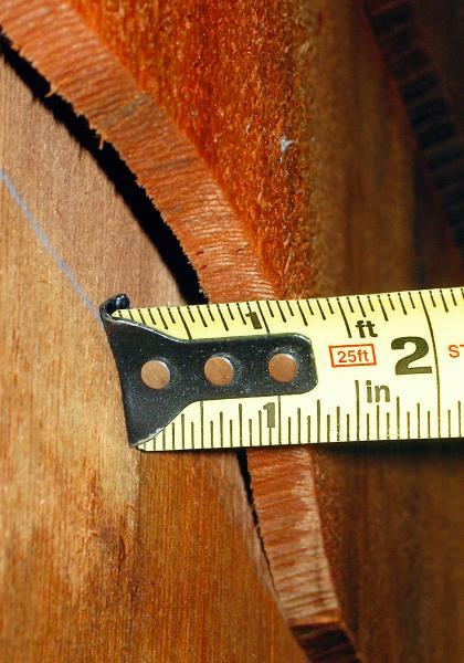

Attached is a picture of an average offender. Yes by the way, they are R&Rs and I correct the exposure, its 5 3/4 to 6 1/4 inches.
Hope your arm healed ok. Dont put the hatchet there anymore.Parkinson's Law: 'Work expands so as to fill the time available for its completion.'
tree... those are still too large by a factor of 10

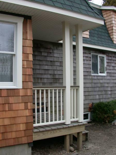

here's some R&R.. typical...
Edited 6/7/2006 9:18 pm ET by MikeSmith
Edited 6/7/2006 9:21 pm ET by MikeSmith
Nice pictures. I remember when mine looked like that.Parkinson's Law: 'Work expands so as to fill the time available for its completion.'
tree.. if this widow is typical....
then i don't think the Red Cedars are squeezing the jambs.. the casing would prevent thatMike Smith Rhode Island : Design / Build / Repair / Restore
It depends entirely on how well the casing is nailed to the wall. If all he did was shoot a couple of finish nails in, then the cedar will easily push it.
