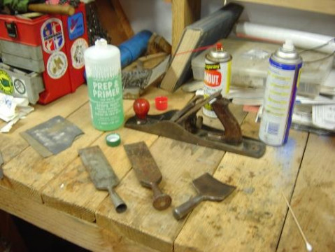

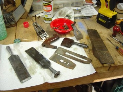

I was in the market for a large framing chisel on Ebay and wound up with a package deal for 30 bucks…an old Stanley 5C Type 16…the Lakeside 2†Framing Chisel I wanted…a beater chisel with a mangled socket…and an old cooper’s shaping chisel:

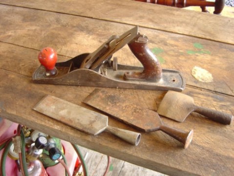

This article will deal with the two framing chisels…the cooper’s chisel was usable as is with some cleaning and sharpening, and the plane I’ll cover in another article, although I’ll rehabilitate them together. These will be put back to work as users, like all my tools…restoration of collector items is another subject.

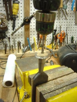

The treasure of the lot is the one in the worst shape; of course…a Robert Duke Diamond Brand firmer-style chisel of lovely, glass-like cast steel. It had lost its handle ages ago and probably served to cut the heads off nails with a large, ball peen hammer in its old age. The socket tang was badly mangled with the remnants of the old handle remaining in the void. The tang was returned to its original form by drilling and filing the socket mortise, and grinding off the metal extruded on the outside. Fortunately, there was enough socket mortise remaining to use or I would have required the services of a neighbor I trade work with…and his TIG welder…to build it up. Using heat-sink paste and wet rags, I might have been able to build up the socket with my torch welding setup without ruining the blade’s temper, but it would have been riskier, and I’m not near the welder my professional neighbor is.

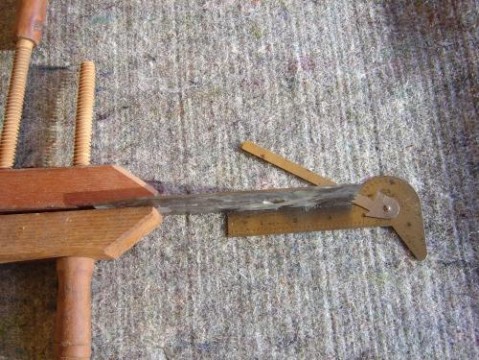

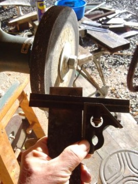

As the blade was badly chipped and had lost its bevel, grinding was required. While I have a jig for this, I rarely use it any more and freehand the 25-degree bevel using lots of water…turn that blade edge 600-degree blue and it has lost its temper and all the blue must be ground away…and I use a square and protractor to check my progress. You should use a 6†bench grinder with all the guards and a proper tool rest for this….and wear glasses, of course.

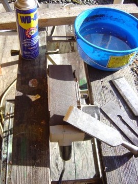

As the other blades are in better shape, and I don’t prefer to leave the bevels of heavy chisels and slicks with a hollow grind (although not important…merely personal preference), I finish the grinding stage for my 25-degree bevels on the belt sander chucked in the Workmate. I use 60, 80, 100 and 150 grits lubed with WD-40 and lots of water, checking my bevel angle and edge with protractor and square as I go.

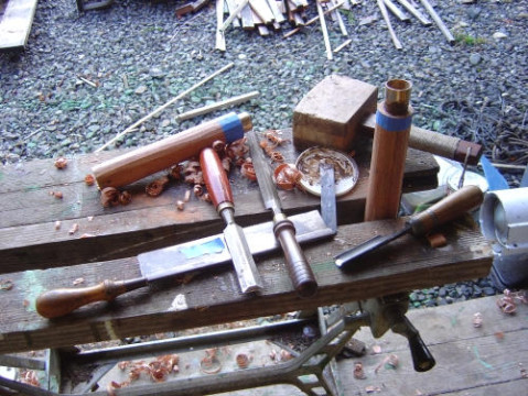

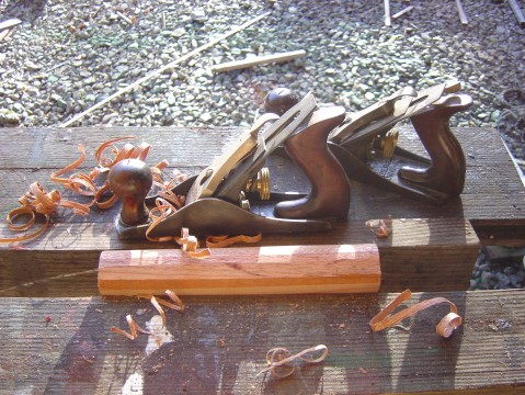

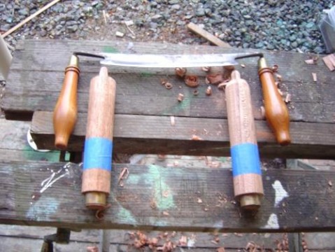

Next I rough out my handle stock. There are better wood choices for handles that occasionally will be struck, but I have some Honduras Mahogany left over from a boat project and will use that. I rip a 2†turning square of it on the table saw, 8-side it on the same saw, and cut two handles to length…the finished length of each handle to equal the length of blade and tang. I then 16-side them using a couple rehabbed old smoothing planes set for coarse and fine cuts. And except for the hanging hole in the 5C above, the Stanley 3C and 4C in the picture were in worse shape when I acquired them to replace the family’s old beech smoothers…the ones I used exclusively for 20 years…I was getting tired of renewing mouths and soles on those.

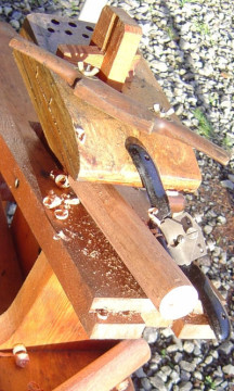

Then I move to the shaving horse and shape them into cylinders using two spokeshaves set for coarse and fine cuts just like the planes.

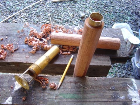

Next I’ll fit the ferrules on the striking ends of the handles. These are simple sections of 1 ¼â€ brass pipe salvaged from an old plumbing fixture with hacksaw and buffer-grinder. The centers are laid out, an interior line penciled…
…and the actual ferrule and masking tape used to lay out the cut line for the saw. The dovetail saw is marked with a piece of masking tape functioning as a depth gage, the ferrule shoulder circumference cut to depth, the waste pared away with gouge and chisel, and final fitting for a tight, drive fit done with the patternmaker’s rasp. I don’t want the
ferrule to slide on easily without crushing wood, so I fit it so the ferrule has to be heated a bit to fit…coat the wood tenon with a bit of thickened and dyed epoxy…with care in making an epoxy bed at the shoulder so the ferrule won’t act as a riving knife and split the wood when struck…and drive on the hot ferrule.

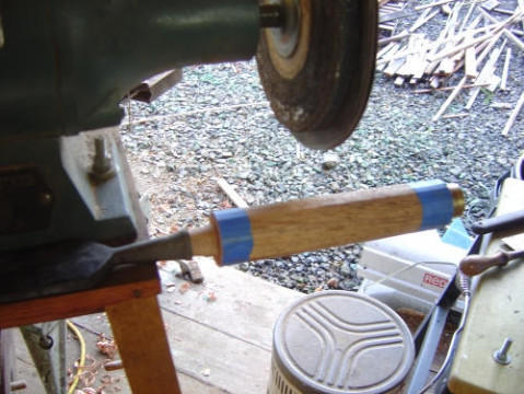

I do similar to fit the chisel sockets. But as these are tapered, I find it convenient to use the sanding disk on the buffer-grinder, driving on the socket occasionally to mark high spots on the wood. You can see the high spots that have to be reduced where the fibers have been crushed shiny by the drive fit…but you can also use sooty smoke from an alcohol lamp burning mineral spirits, Prussian Blue machinist layout paste, or Mama’s lipstick to perform the same function.

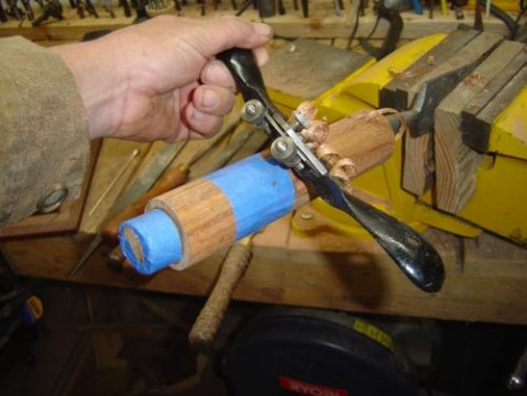

Next I want to lay out the shape of these 2†diameter handles. As my favorite handle shape is one I used for turning cherry handles for Grandpa’s old drawknife a couple decades ago, I simply eyeball the proportions for the new handles and lay out my guidelines using masking tape that I will simply slice through during shaping.
The sockets are also driven on with thickened epoxy.
After the epoxy cures, I rough out the shape using coarse spokeshave…

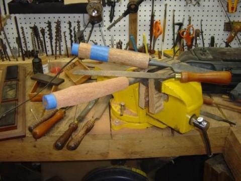

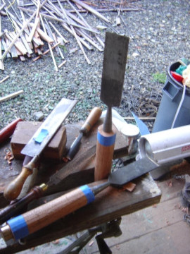

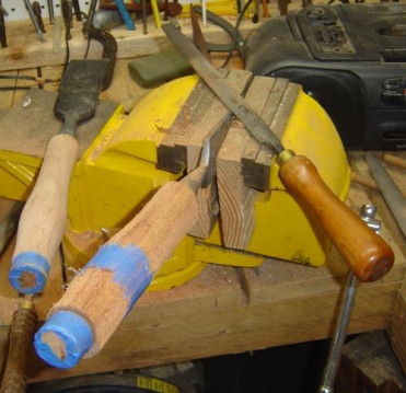

…and coarse rasp. Note the selection of finer rasps and various old machinist files on the bench. The better you become at cross and draw filing and the better your selection of file grades, the less sanding you will have to do. And smile knowingly but ignore pundits who claim only cutting blades should ever touch fine wood. Like those folks who claim planes should always be left on their sides instead of their soles when laid down, these practices are hardly universal among master craftsmen…or even important, for that matter. I’ve seen it done both ways in a dozen or more shops I’ve worked in and observed…and I’ve seen it done both ways well. In fact, all the master stock makers I know always reach for the rasps when working thousand-dollar blanks of figured walnut for wealthy and discriminating clients…no risk of tear out in swirled grain that is impossible to read, let alone slice cleanly.
If you are confident using successive grades of abrasive paper, you should be just as confident with rasps. The work looks ugly, but the ugliness only extends to the depth of the teeth, and is removed with successively finer rasps with finer teeth…just like sandpaper. Rasps are really precision instruments. And those large old 3-dollar machinist files in flea markets do yeoman service on hardwood long after they are too worn to cut steel. Learn to use them, and you will never need or even be inclined to use a power sander on a sculpted surface like these…finish sanding becomes a snap.
Also note all the different file handles on the bench…some are nicely shaped…some are as ugly as toads. Like you rehabbing your own tools, they were all lathe practice from 30 years ago. And it’s good to have your reject work around in the shop to look at every day…the stuff that makes your teeth itch every time you look at it…helps keep your ego where it belongs.

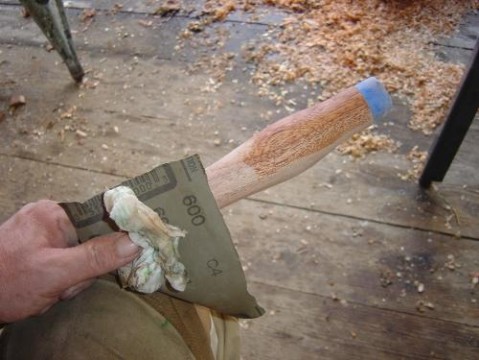

I finish sand the shaped handle in minutes with successive grits of 80-220. The 600 grit shown is merely used to polish occasionally as I go to reveal sanding scratches I missed. I also dampen the wood with water between each grit…it reveals scratches I missed, but more importantly, it swells the fibers in those scratches so they can be removed with little hollowing of the surface. It will also prevent the grain from raising beneath your finish when the tool gets wet for the first time. Another stock maker’s trick.
With one handle completed for a model, the second and any subsequent handles can be made much faster, as there is a lot less trial-and-error eyeballing of your shaping progress. The first handle took 45 minutes to shape and sand, the second one will take 25 minutes. Don’t try to go fast, take your time, learn as you go and enjoy yourself. I’m just pointing out that with practice, this level of work can be done by hand at a decent pace. And this practice time is hardly wasted if your ultimate intent is a nice wood lathe….over half of fine lathe work is eyeballing graceful proportions.

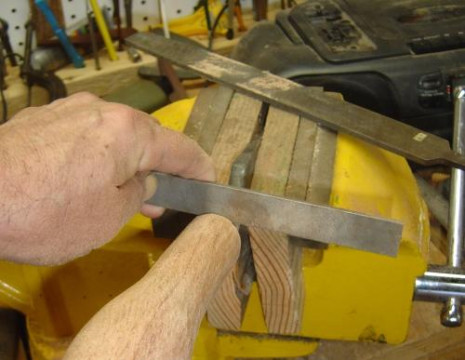

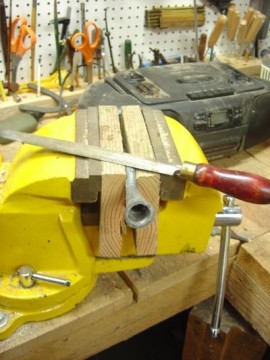

One nice-to-have tool for this work is a file with a “safe†or untoothed edge to mold those epoxied shoulders nicely.
