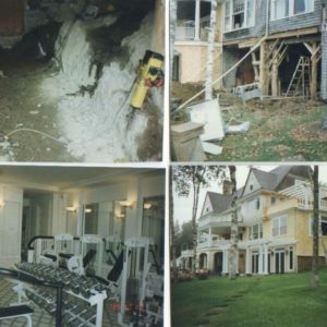

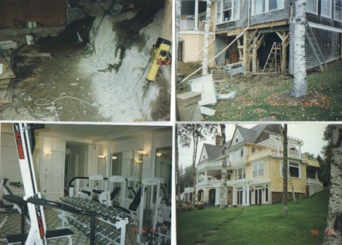

  7. Piffin | Jul 14, 2003 06:42am | #18
    Here's a picture of the brutal animal alonf with before and after shots of the job it worked on. The gym is in the basement level of the house corner nearest you
