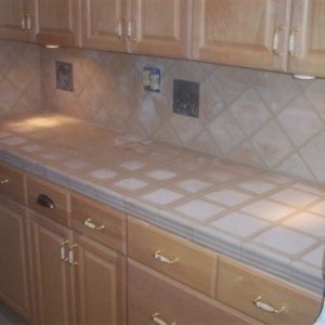

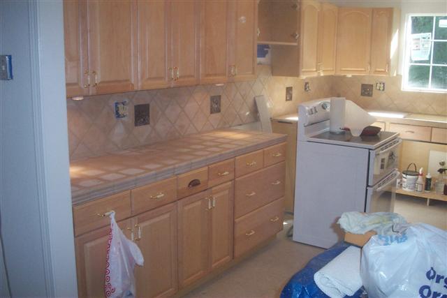

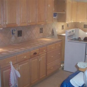

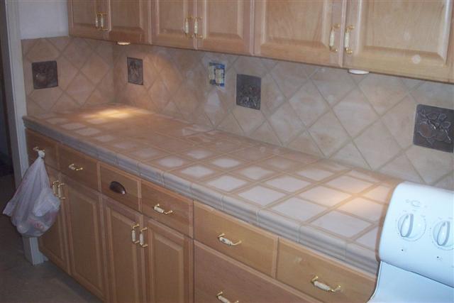

            Here are a couple of pictures of a kitchen I did last year.  The countertop was a breeze, but the backsplash was a major PITA.  Between the receptacles in the walls and the accent pieces, I spent lots of time measuring, marking, and cutting.  To add to the fun, my tile saw was about 75' away and I had to contend with three dogs who thought that their job was to run thru the door whenever it was opened.  I was sure glad that the job was T&M.  Anyone have any cheese to go with my whine? - lol

            Seriously tho - nice tile work.  Sorry ya had travails but hey, it gave ya a story to tell tho.
            Anyway - personally - I still cringe inside when I see tile on kitchen counters (or bathroom countertops) cause I find from living with them, that I hate hate hate dealing with groutlines on those horizontal surfaces.  I know I'm an oddball but hey, there it is.
