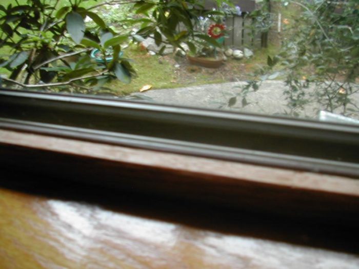

  7. junkhound | Oct 08, 2006 05:51pm | #10
    Do what Dan suggested.
    I've replaced fogged insulated glass with plain panes, you already have a pane in place.
    All I did was add a strip of EPDM rubber to the Alum frame on the inside, put a new pane against that, and screwed on wood retainers.
    here is an example, you have a 1" air space then also, and can pull the inside pane after 5-10 years for cleaning if needed.  just like the old fashioned strom windows.
