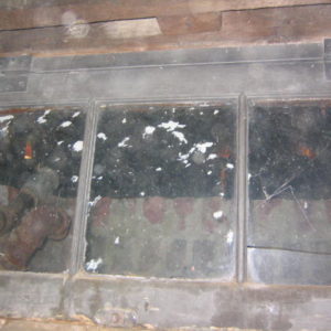

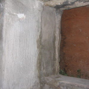

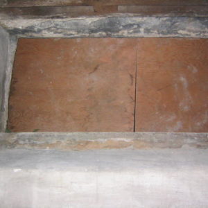

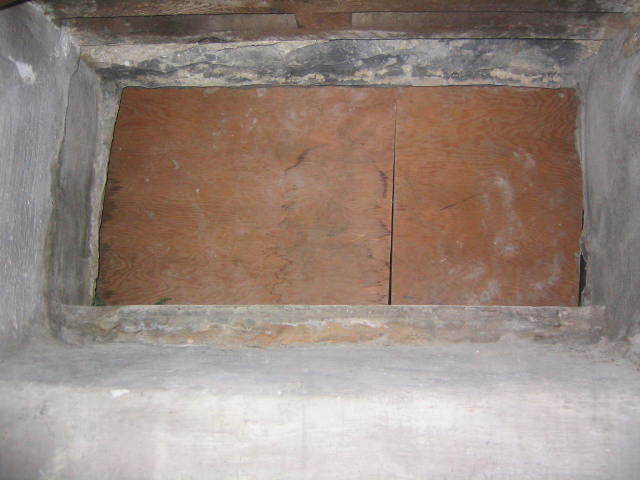

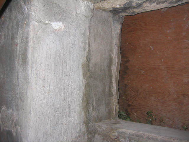

I am having problems installing vinyl replacement windows in my basement. The wood framing had a lot of old termite damage and had to be removed. That made the opening much wider than the window I purchased. I can fill it in with wood, or purchase a new window, but am unsure of the techniques to use.
The original window fit inside a frame that was a perfect fit. The new window doesn’t fit perfectly. I have several questions about how to proceed. The sides are now flat (I mortered over the stone work), but the top is rough. The bottom is sloped to the exterior. The opening is about 37×17.
1. Should I attach wood to the sides of the opening and the window to the wood, or is it best to just get a bigger window and attach that direclty to the morter?
2. The depth of the original wood was 6in from front to back (that is the area on the left that you can see is newly stuccoed), and the window was at the back of the 6in, towards the interior. On the bottom of the 6in deep area, it is sloped. If I place the window on the sill, there is about a 1/8in gap at the bottom exterior due to the slope. Can I just fill that with caulk? Alternatively, I can install the window a few inches to the interior, in front of the sill, though that requires I make a ledge for it to sit on (perhaps a 1×2 on edge)
3. If I use wood, it is better to use PT or Cedar? I prefer to work in Cedar, but is that OK for contact with the masonry?
