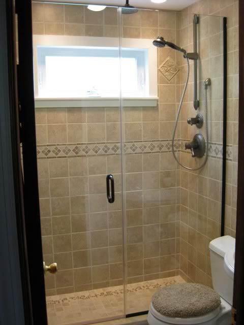

Just finished putting in a Schluter with the tray. It was my first time and as a DYI'er it was easy and fast. They get my vote.
Never seen a shower on it side before.
How do you use it without falling out????

OHHHHH...now I understand.
The shower head & shower valve goes on the side, not the top!!!

Great looking job!
As a DIY, how did you prepare for doing the work? How much time invested in doing the research, the learning, practice, etc.? How much outlay for tools you might not use again for a while?
Why did you decide to go DIY, and not hire a pro?

Thanks Gene,I spent a lot of time on John Bridge and of course Breaktime. I spent about a month doing research and I also tiled a bath surround on my second floor bath first. The only expensive tool I invested in was a tile saw and even that was not to expensive. I got the Felker FTS 50. It looks like a small table saw. Now for the down side. It took about 4 months. Some weekends I would get up bright and early only to find out I had to go to my kids basketball game. I got very good at back buttering tile. I found out that putting a few tiles on any second I had time was the only way I was going to finish. I did hire a glass guy, I could never have done that.
The main reason I did it my self was money. I also like the satisfaction of doing things my self.
It was a gut job, new window with Azak trim. new plumbing for the shower (toilet and sink were Ok) Kerdi shower, Warmly Yours heating mat. Two nooks and granite for the curb cap and the door saddle. Total cost $8,500.00. Est. from the pros, $16,000-$20,000
Perfect! Now ditch the toilet toupee ;o)
I know, I know, but the DW wants it.
