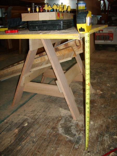

            I do prefer drywall benches
            You know, that gives me an idea.<!----><!----><!---->
            What if I built my own walk-ups and made them lighter than drywall benches?  I could make them similar to plywood sawhorse/staging, except make the top wider (so I wouldn’t have to use a plank) and the rail stronger (to use as a step).<!----><!---->
            I could also make them just a little less lengthy that drywall benches.  Since most walls are no shorter than 7’, I can make them each 3’ long.  That’s a total of 6’ to leave room to stay off the walls.  If the wall is a little longer, I can always spread them out a little bit.<!----><!---->
            Finally, I should make them so that they’re just as comfortable as a ladder for getting up and down.  However, they should be just steep enough to fit into tight spaces, which means no wider than a ladder turned sideways.<!----><!---->
            How about this for materials:  The two sides will serve as legs and be made from ¾” hardwood plywood.  The top will be 1x8 pine with it's center supported by hardwood plywood on edge.  The rails that serve as steps will be made from 2x3 pine and be mortised into the plywood sides.<!----><!---->
            What do you think?<!----><!---->-T
          39. User avater
            basswood | May 29, 2008 01:52pm | #122
            Sounds like a plan.If they could stack for storing, all the better.
          40. User avater
            JourneymanCarpenterT | May 29, 2008 06:36pm | #123
            Your too easy.
            Do you think I could get away with using 1x6 instead of 2x3 for the stepping rails?  To properly proportion it, I feel like the top and rails should either both be 1x or both be 2x.
            What about the top?  Do you think 1x8 is wide enough for the top?  I wear a size 10.  Perhaps a 1x10 would be a little more appropriate.-T
          41. Jim_Allen | May 29, 2008 07:38pm | #126
            We use to call that a "walkplank". Bob's next test date: 12/10/07
          42. User avater
            JourneymanCarpenterT | May 29, 2008 08:53pm | #127
            Okay, a "walk-plank" then.  Just as long as we understand we're talking about a 3' long board that's attached to one sawhorse and not spanning two.  What do you think?  Would you say a pine 1x10 would be strong enough for a walk-plank?<!----><!----><!---->
            Each end will be supported by 2 hardwood plywood sides that are 3/4" thick.  Each of the two triangular plywood "legs" will be cut at a 3 1/2" width at the top.  The center of the walk-plank is supported by a 7 1/2" wide rip of 3/4" thick hardwood plywood turned on edge.  The span is 3'.<!----><!---->
            That will create a 2 7/8" overhang on either side of each plywood "leg."  Between each leg there will be an overhang of 4 1/4" on either side.  Perhaps that's why I started out thinking about a 1x8 even though a 1x10 would be more standard for this kind of application.<!----><!---->
            What I'm thinking about doing to strengthen the 1x walk-plank and still avoid the weight of using a 2x, is fastening 1x2 cleats turned on edge to the top of both sides of the 7 1/2" hardwood plywood rip.  That will still leave a 2 7/8" overhang on both sides of each end, but it will only leave a 3 1/2" overhang on each side in the center, as opposed to an overhang of 4 1/4".<!----><!---->
            Also, what do you think about the 1x6 side rails turned on edge?  Do you think they would be strong enough to use as steps?<!----><!---->
            -T
            Edited 5/29/2008 3:56 pm by JourneymanCarpenterT
          43. Jim_Allen | May 30, 2008 03:14am | #128
            I've worked on 32" `1x12's for years. The actual span was 29". There was always a hole cut in the middle for a hand grip. I have split some of them but the split never occurred without warning and since I had solid supports, there was never a danger. If you intend to support the 1x10 with only the four exterior legs, there is a substantial danger of in instant split that will cause injury. Mitigate that danger with a simply plywood gusset and you are "good to go".After you've built your fifth of sixth one, you'll have all the necessary customized features that make you more productive than you've ever been! I worked with an old carpenter that used to build a 7' long version of this walkplank. He used a 2x10. Bob's next test date: 12/10/07
          44. User avater
            JourneymanCarpenterT | May 30, 2008 06:21am | #131
            the middle for a hand grip. I have split some of them but the split never occurred without warning and since I had solid supports, there was never a danger. <!----><!----><!---->
            If you intend to support the 1x10 with only the four exterior legs, there is a substantial danger of in instant split that will cause injury. Mitigate that danger with a simply plywood gusset and you are "good to go".<!----><!---->
            Thanks.  Since there will only be 2 legs, each side solid 3/4” hardwood plywood (example), I guess I should be fine.<!----><!---->
            You never did say weather you thought you thought a 1x6 pine side rail would be strong enough to use as a step though.  That’s okay, I have a feeling it will just make it.  Besides, that’s just the simple version.  I wanted to see what you thought of it before I told you about all my ideas for the bells and whistles.  But, since you opened the door . . .<!----><!---->
            After you've built your fifth of sixth one, you'll have all the necessary customized features that make you more productive than you've ever been! <!----><!---->
            . . . I guess I’ll go on.<!----><!---->
            I like to do things right the fist time.  I plan on living with these things for at least the next 20 years, so let me tell you about my other idea in place of the 1x6:<!----><!---->
            I was looking at my 2’ stepladder, and if I make my trestles a 24” height like Basswood recommended (coincidentally the same height as a 2’ stepladder plus the thickness of a plank), I’ll need two steps to make them as comfortable as my stepladder is.<!----><!---->
            The stepladder uses 1x4s on the flat for the steps.  To help support each step, truss rod about 3/16” in diameter is dadoed into the bottom of them.  Now, the wooden stepladder is only rated for 200 lbs, and you can feel how fragile the steps are when you walk on them.  What I thought I would do is dado two truss rods into the bottom of each step. A 2’ stepladder is only about a foot wide though, so hopefully this will still be strong enough to support a 3’ span.  I suppose I could also use 1/4" instead of 3/16” if I’m really concerned.<!----><!---->
            Besides using two truss rods for support instead of one, and possibly increasing the diameter of the truss rods from 3/16” to 1/4”, there’s something else I noticed I could do to help support these steps, or 1x4s on the flat.  My 2’ stepladder has metal angle brackets supporting each end of the first step, but not the second.  I think I’ll use the metal angle brackets on both.<!----><!---->
            Well, if the extra truss rod won’t be enough to support the flat 1x4 side rails I’ll be using as steps, I could always go with 5/4 pine for a full 1” thickness.  It would be nice if I don’t have to though, since it would add weight to the walkup.<!----><!---->
            Wooden stepladders also have ribs routed into their steps for traction.  Perhaps I’ll do the same for the 1x4 (on the flat) side rails on these benches.  I’m thinking I should do the same for the walk-plank.  After all, that’s how they make drywall benches.<!----><!---->-T

          46. Jim_Allen | May 31, 2008 01:57am | #133
            1/6 sounds too heavy for me. I always made things ultra light. Bob's next test date: 12/10/07

    basswood | May 24, 2008 12:58am | #16
    I have been installing crown with 9 and 10' ceilings at the house I am trimming now. I like to stage two walls with benches or short saw horses and scaffold planks.
    I prefer this to climbing up and down ladders. Nice to be able to walk the perimeter of the room and work at a comfortable height. This is especially true for large crown (this job is 6-1/2" crown).
    Nice to be able to walk around and mark studs, install backing, and install crown--without climbing much.
      JourneymanCarpenterT | May 24, 2008 06:20am | #19
      Thanks for the picture.  The more I think about it, the more it seems like small custom sawhorses are the way to go when supporting planks at this height.<!----><!----><!---->
      At 5’ 9” a 2’ stepladder (which is actually 22 ½”) puts my head just 3” below the ceiling when you add the 1 ½” plank.  However, Werner’s 2’ wooden step ladder is only rated for 200 lbs.  There’s just not enough of a safety margin there for me to feel comfortable.  Werner’s 2’ aluminum stepladder is rated for 300 lbs, but I don’t know if I like the plastic top step.  It just seems like it would be too slippery for scaffolding.  Then of course, if I’m working 10’ like you are in this instance, a 2’ stepladder doesn’t do me much good.<!----><!---->
      Keeping my head 3” below the ceiling seems like a good idea because it will keep me from having to have my arms stretched out over my head all day, but then, right now I’m used to working off a ladder.<!----><!---->
      I think I might like to make some custom sawhorses 34 ½” in height (for 9’ ceilings), with supports at 22 ½” (for 8’ ceilings), and 16 ½” for ceilings at 7’ 6”.  This setup will only bring my head within 15” of 10’ ceiling, but I should still be able to reach the crown with an outstretched arm.<!----><!---->
      I’m not exactly sure about the lightest way to go about building them, but I was wondering if 1x4s would be strong enough for scaffolding.  However, it looks like those 1xs in your picture.  If this is so, then perhaps I will make them out of 1x4s and 2x4s.  <!----><!---->
      I’m thinking about making them 12” wide to support a single 2x10 or 2x12.  I’d like to forgo the flat top piece for less weight and simply bolt 4 mitered 2x4s to 1 horizontal crosspiece.  Again, for less weight I’ll use a 1x4 for the top crosspiece, but I’ll bolt straight through one opposing 2x4 leg to the other for strength.  Then I’ll mortise into the 2x4 legs for 1x4 crosspieces at the lower heights of 22 ½” and 16 ½”.  Since the 1x4s will be supported by their mortises, I think I’d like to mortise in ½” plywood gussets 12” long in place of the 1x4 crosspieces in the picture.  I’ll miter the legs at a 13 degree angle to keep the lower 1x4 crosspieces as close together and as vertical as possible for strength.  It should also help keep storage space to a minimum.  Do you think they’ll be strong enough?<!----><!---->
      I’m guessing I’ll need about 10 of them for the average room.  Perhaps about 20 for a large room with a miter saw station in the center.  I could probably store them in two stacks, stacked 10 high.<!----><!---->-T

        basswood | May 24, 2008 02:45pm | #30
        JCT,Those horses are 3/4" plywood and stand 24" tall. They work well for 9' ceilings. They are light and strong...2x stock is overkill for my uses. My work benches are a couple of inches shorter and are ideal for 8' ceilings. For 10' ceilings 3' horses work well, or a small scaffold on wheels.Have a good weekend,Brian
          JourneymanCarpenterT | May 24, 2008 10:06pm | #35
          Wow!  3/4" plywood it is then.  I think I'll make mine similar to the Burro design, except instead of 1 lower horizontal spreader in the center, I'll make at least 2 - 1 for each side like you have.  I think I might still like to mortise them in though.
          I'm starting to think about making two different kinds, one for one for 9' and 10' heights and one for 7' 6" and 8' heights.  I picked 7' 6" because I can reach 7' stretching from the floor and  7' 4" seems to be a little too ridiculous to use scaffolding for.
          I'll have to reconsider a 24" height for installing 9' crown.  However, I think that would but my head 13" below the ceiling, which means I would have stretch out my arms and bend my neck back looking up all day long.  That's ideal for actually installing ceilings, but I wonder if you might be taller than I am.-T
