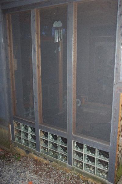

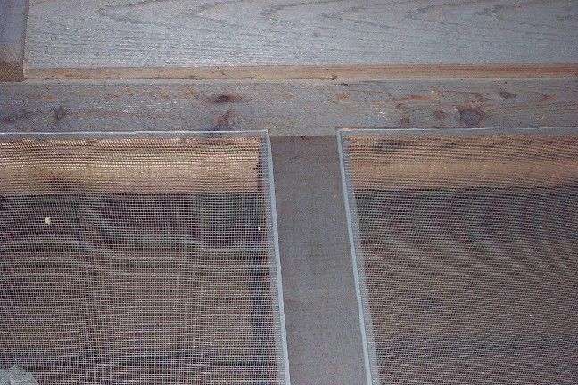

Here is a pic of some not usual porch applications. The nice thing about the screening is that it is installed like a screen insert only the vinyl spline that holds the screen is inserted in a groove cut in the posts. Easy to install, and easy to replace. With a dog and some cats I used some salvaged glass block to keep the lower light coming in and no damage from the animals. Casts a nice light in the evening and it got rid of those damn boxes of block I had stored for 15 years. Maybe you won't like it, but it's something to consider. Best of luck on that porch.
