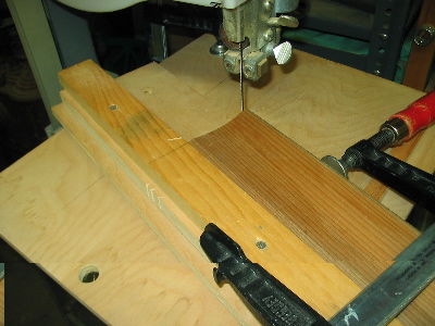

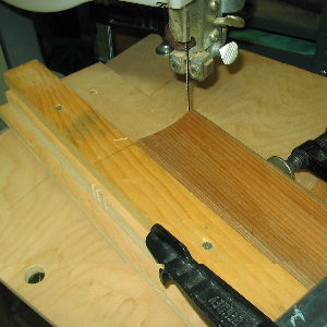

    I don't know if this is "typical" and it will depend on other details but I cut a piece of 2xPT to fit in the column and attach that to the deck. You can do the same on the top if the column doesn't have a capital. I cut the ends of my railings on a radius to fit the columns and attach directly to the column. The rail profile will determine whether you can just angle large screws, use a bracket, slot out for a rail bolt or maybe let in the rail. Here is a pic of a simple bandsaw pivot jig for curving the railing ends. It's probably self explanatory, base piece of plywood, pivot on the inside and in line with the front edge of the blade, moving fence that centers the rail with the pivot. Don't cut through the fence.

      Hammer1: Thanks for your reply and ideas. I think they'll work. For attaching the railings, I think the radius on the rail, along with screws and glue, ought to keep them in place.  And the 2x plugs should hold the columns in place. I didn't know if there were any trade secrets about doing this correctly.
