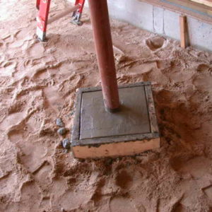

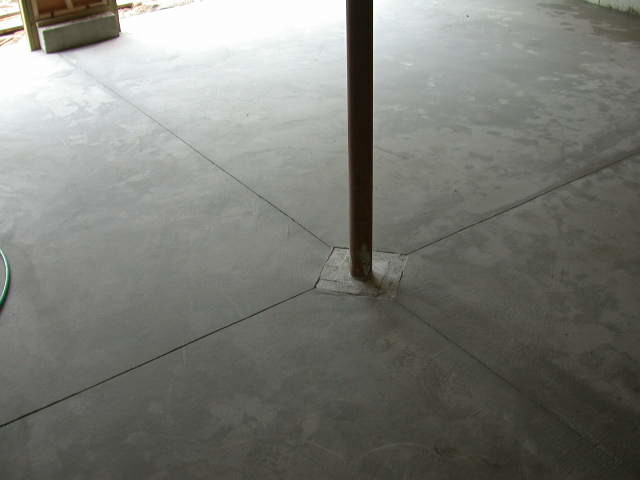

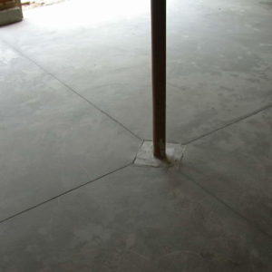

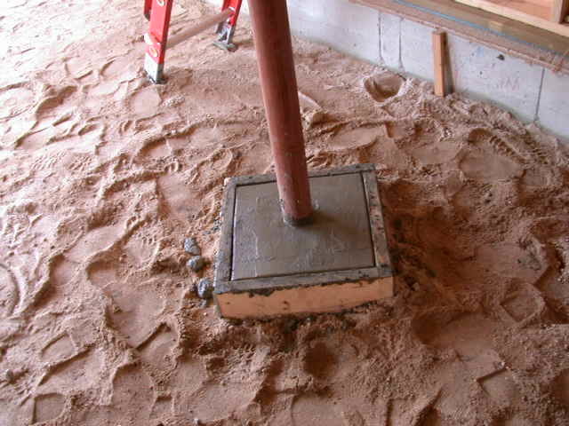

            here's some lallys set
            and a blockout formed to be even with the top of slab
            and some saw cuts to act as control joints

            good picture. good work. we been using round sonic tube for blockout just to elimnate corners. cracks love corners for some reason.
          3. DanH | Oct 10, 2006 05:32pm | #21
            But putting the corners on the relief cuts, as shown, makes the corners work for you rather than against you. With no relief cuts round is probably better, but the form needs to be large enough to surround the footing.
          4. luke | Oct 11, 2006 04:14am | #22
            Your explaination and pictures are perfect. The check is in the mail. Thank you!
