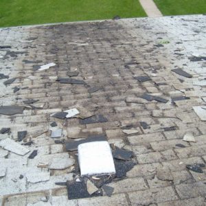

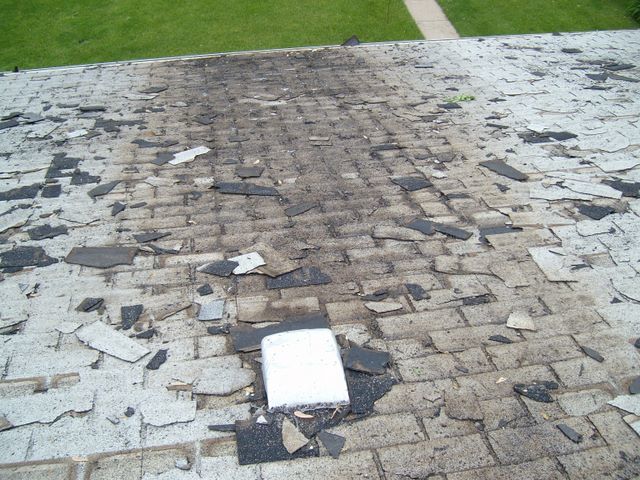

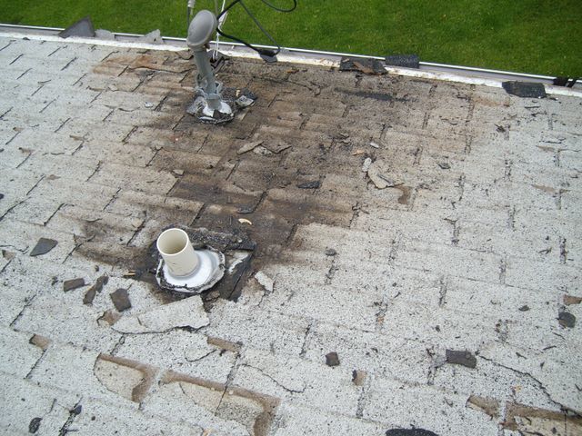

We are doing a reroof on a 1970’s ranch with a 5/12 hip roof.
I always recommend tearing off the old shingles. This roof had 2 layers of asphalt.
The previous roofers shingled around the old vents and flashings.
In the pictures you will see why that is not a good practice. 1st layer is already off.
Plywood was ok but everything downstream of the vent was wet.
If you have to shingle over, then buy new flashings.
