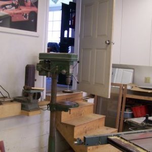

My shop is dug-in 32" below my garage (walk-out on the low side). I just ran 4 courses of block, and painted dryLock on the inside of them, after filling the cavities with vermiculite. Wood framing above. Ten years ago.
Only leak (weep) came from my drilling a hole in the slab for an anchor bolt. Earth is a great moderator - rarely have to heat/cool it.
I can post pix this AM if it would be helpful.
Forrest
Thanks. Would love to see pictures .
Paul

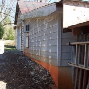

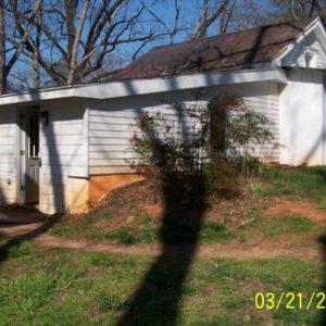

Okay - didn't even straighten up for you! Original ~1930 garage on the right; I had put a slab and entry ramp in years ago, then leveled the ramp and made the 4' bump-out on the ramp recently, when I moved the garage door to the back. The sloped roof to the left started as a lean-to shed on grade; I extended it and dug down.
You can see our decorative Georgia clay splatter.

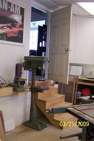

Now to the inside - through the door, you can see the 4x6 pane window of the bumpout from the first picture

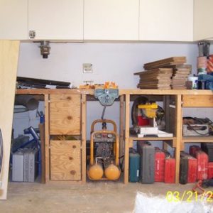

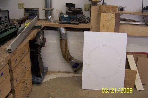

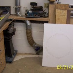

Here you can see how the tables clear the 4 courses of block - their top edge is visible behind the vice over the compressor.
Forrest
