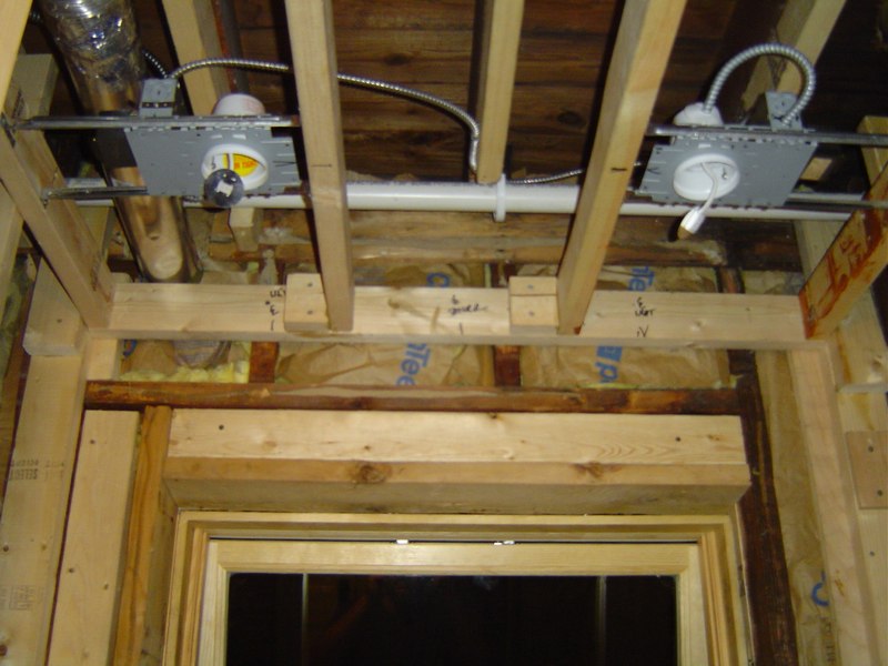

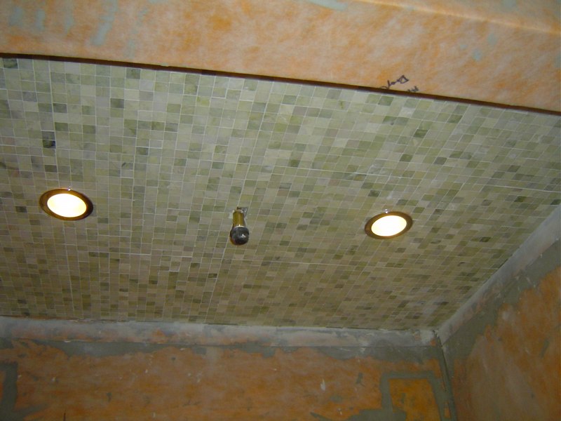

I just put some really nice 3" low voltage can lights in my shower.....with "wet space" trim kits.
They have the transformers built into the assembly. They were about $35 or $40 each from http://www.lightology.com, a really cool lighting store in Chicago.
Here is the link to the product, scroll down and you'll see the trim kit, R3-409C (click on it), http://www.lightology.com/index.cfm/method-light.store_profile/sku-1220RS-R3499AT-003H1-00R3/dept-Recessed/szdept_label-
Here they are installed......
I am done with cheap can lights. The extra $60 spent on each fixture and trim kit was really worth it....the 3" is very nice and I have dimmers on them, they are on their own circuit.

I like that shower ceiling that you got there - anymore pics of the whole room?
Your fairly new here and you've posted some nice stuff, fill out your profile so that we at least have an idea of where you are, dont need your address or anything like that, CC # wont hurt though!
Edited 4/7/2007 10:16 am ET by DougU
Thanks on the bathroom, I have just about finished everything.....got the 1/2" glass door in last week, took my first shower this week, it is heavenly!
I am hanging towel racks today, I will post pics of everything when I am done.
It's got all the bells and whistles.....including warmboard flooring (of course now I have to install a radiant floor heat system in my house), 4 lighting circuits, thermostatic controls for the shower, etc. Here's a teaser:
