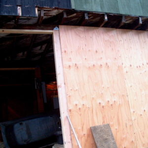

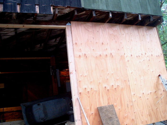

          Jim, hope this jpeg is clear. I would continue with layout if I sister but it sounds as though a ledger is preferable. Can you clarify: "posts and girt or whatever outboard."
          Also, any ideas of footing on a 30 degree slope? I have looked at the "bigfoot" system. Again, I want it to be sturdy and weather proof. It snows there on occasion and rains a bit more than in the valley down below.
          I like the micro brew suds. And am considering brewing myself..... The Cabin has great water and I am building enough space to brew (unless my wife appropriates the area ;))!

            Boy oh Boy does your photo look all too familiar! I've seen about a gazillion like that. Makes me feel right at home, LOL....
            If you want it to be weatherproof, you will have to seal and insulate the blocking between the sistered joists with expanded foam on the inside of the house. Also pay attention to flashing details on the outside. Best to have a nice large overhanging roof to keep off most direct water. You should figure on sistering both sides of the joists with minimum 3' sections of 2x6; use ½" through bolts with big flat washers on 12" centers, staggered high and low, and squirt some structural construction adhesive in there for good measure.
            If you elect to support the deck joists on a ledger, you have to make sure the ledger itself is well supported. Lag bolts into the end-grain of the floor joists of the house will have a good shear resistance, but won't do the floor joists themselves any particular good. If they split, your ledger will sink. I would use a doubled 2x6 ledger supported by 4x4 posts set on solid footings, every 6 feet or 3 sets of joists. The footings can be 'Bigfoot' bases, but if you're in a freeze zone, you should set the bases on a compacted gravel pit deep enough to let any water drain out so you won't get any frost heaving to lift your deck. Otherwise, go traditional and dig sonotubes down below the frost line; then pour concrete pillars to come a few inches above grade so the 4x4's won't rot out.

            Obviously, I can't tell much from one photo, but you might want to consider some diagonal bracing on those existing posts to prevent sideways movement.

      Thanks for all the good input! I have added a detail of joists for those still interested. I believe I will add a ledger and lower the deck off of it. Water damage is a real threat as this is an exposure. Again thanks for all the words.
      I'll hoist one for all this summer as I stand on the deck one fine summer day...
