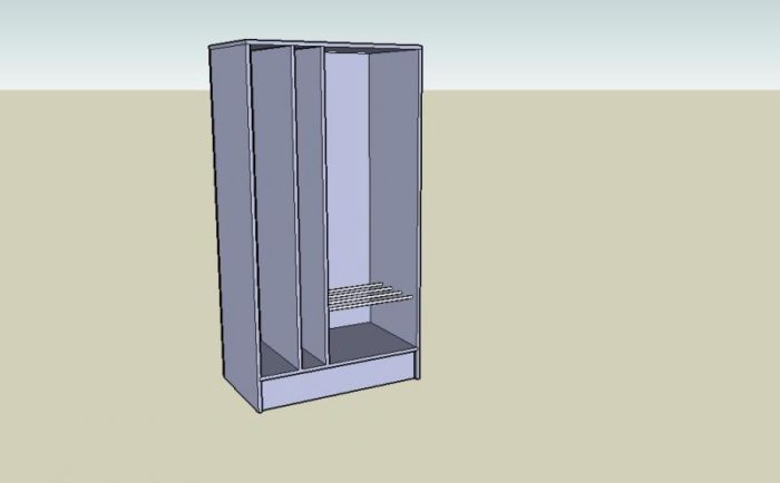

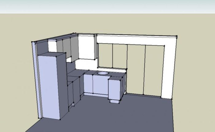

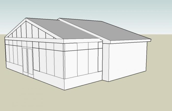

I’ve attached a couple of my drawings.

Group every part you make as soon as you make it. I make a stud, then group it, then MOVE_COPY it wherever I need it. Same with walls, roof planes, cabinets, countertops, etc. Grouping is the solution to almost everything. You can right click to edit a group anytime you want.
