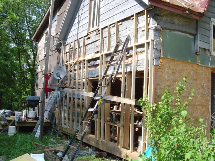

          I have the west ward wall, thet gets the hit..it was logs ( white oak, and chestnut) about 6" thick, being as they were dovetailed to the corner, they have a sizeable daubbing space ( was rocks and plaster, and mud).
          I have an addition on the same plane, that is 4'' or so beyond the logs..what I did was stud  out the difference and add rigid foam insul, and am hanging osb as  a ............
          now ya got me..why am I hanging osb?
          Ok, hardie plank is my goal, as is getting as much as I can from the insul ( we are not in the artic after all)...
          Currently I heat witha woodstove..which I intend to upgrade this yr. I have 2 rooms that are "comfort" in both winter and summer..they are in the addition that was added..
          we occupy 2400 sq ft, we use one tenth of that, due to ongoing construction..
          Yer input is really recieved with open mind..keep it coming.?  Spheramid Enterprises Architectural Woodworks

          My situ is rather unique, I have to cover over the bad wall( logs) and I have framed a stud wall on the ext. My total thickness is now 10", I have used the polyiso in 2" lifts ( if you will) and 7/16 osb sheathing.
          I am foaming all the mateing surfaces, and inthend to leave the logs exposed on the interior.
          This house is about 175 yrs old, I;ll die before it is "done", I intend to bequeath it to my daughter..so, I have a real plan.
          I really appreciate the help you have shared..but boy oh boy does it FU my schedule...LOL.
          If I keep changing my plan and attack, I'll never get it done.
          I be rethinking.  Spheramid Enterprises Architectural Woodworks

          3. RayMoore2G | Aug 07, 2005 07:36pm | #27
            It sounds like the 30 lb. felt is the way to go. Two layers is even better, especially if you are not going to use a furring strip behind the Hardie. The two layers will form a path for water to drain out that gets behind the siding. The outer level will protect the inner layer from the elements during construction.
            I'm not entirely clear about your wall assembly. Did you cut two layers of polyiso in between the studs? Then you sprayed foam between the logs and the stud wall at the perimeter to keep air out? If the answer to both questions is yes, then you have a good plan and I see no problems if you switch to felt paper.
            What is the foundation that supports this wall?
            Sphere | Aug 07, 2005 07:48pm | #28
            Yes, the answer is yes.

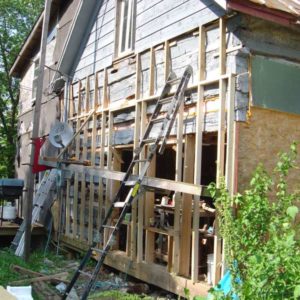

            This is a gable wall, I used a double 2x10 pt lagged to the sill log that was not horrible. I then ripped 2x6 in half and made a sort of facade of studs, bearing on the 2x10's and top plateded to the existing ( it was 4" outta plumb in 8').
            A log home is all header. and the gable side really is over kill. But I had to keep the wind out ya know?
            All the pics can be seen at ( I bet I can't post the link, without being speroed)..Photos , My ol kentucky home take 2..lemme see if I can post of a shot from the west wall to make it more real for you.  Spheramid Enterprises Architectural Woodworks

          7. RayMoore2G | Aug 07, 2005 08:46pm | #31
            It looks good. Three things you will need to do are air seal, air seal, and air seal.
