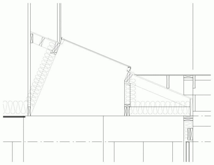

I am designing a house and want to incorporate a skylight into the design.  The skylight will will be placed above the entry inside the home.  The roof design is a hip roof with dutch gables.  I am placing the sky light on the dutch gable side of the home.  The problem is that i have is that i have a an exterior gabled porch roof over the entry of the home.  The positioning of the skylight will put the bottom edge of the skylight within 4 1/2″ of the ridge of the entry roof.  Do you think i can properly flash the skylight and have the ridge and the two valleys be sealed from water intrusion?
  1. JohnFinn | Apr 26, 2010 06:07pm | #1
    I don't see the ridge as being problematic, however looking at the attachment is that the gable end (on the left side) right next to the top of the skylight?

    aldernester | Apr 27, 2010 11:02am | #4
    Yes that is the gable end on the upper left hand side.
