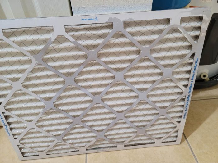

A wet air filter commonly indicates a clogged condensate pan or condensate drain lines. ... When something prevents this water from draining away, it overflows and the air filter may absorb that moisture. Another possible cause is moisture that may be falling directly onto the filter from the evaporator coils.

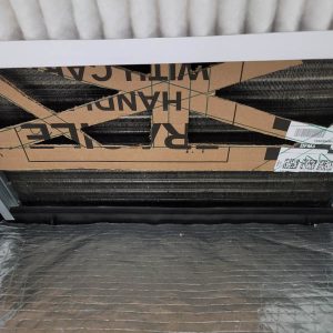

I have a brand new Rheem slant coil A/C handler and heat pump. After 1 day the filter was getting wet in various spots up high. The firm that installed it came out and slowed the fan one notch as it was sucking the filter into the condensate coil. I also made a 1/8x20x25 cardboard spacer almost identical to the aero filter cardboard side and placed that between the filter and the coils. Still gets a good seal. Will let that run for a bit and see how it does. If it works well I will make one out of plexiglass and put the 3M Merv13's in the aero's place. It's not the condensate drain - it's just the filter is too close. We are in Florida and the A/C runs quite a bit. You can also up the temperature on the thermostat so it doesn't run as much and create as much condensation.
Wet filter and spacer

Ran it for a few hours. Filter stayed dry. Cardboard had a few minor wet marks. Now to get a piece of 1/8 inch x20x25 piece of plexiglass or plastic, cut some holes in it to match the aerostar filter and replace the cardboard.

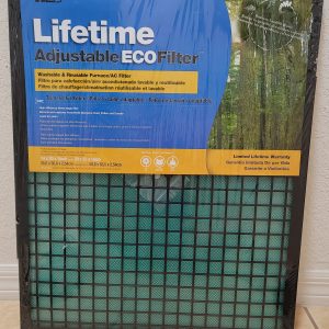

Found something else that might work. I could use this filter as-is or take the grid out and put between the paper filter and coils. $23 at Lowe's or probably Amazon. Saw it and thought it would save msking my own spacer.

Decreasing not increasing helped because it doesn't pull the filter as close to the coils with less suction. No more wet filters. Happy camper.
My filter is well below my coil, 4" style filter in it's own box area. The coil is a 45* slant creating an A-frame
