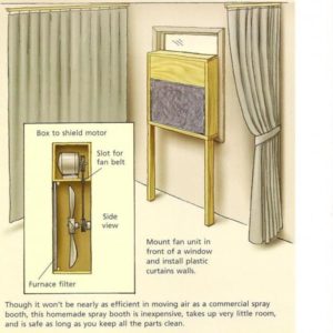

    You're making this too hard. Any fan motor, hook a belt to it. Put a fan blade on an axle in a box, connect the belt. Done. Keep the motor outside of your spray booth and use the new "box fan" as your exhaust fan.

        What money?  Take an old box fan, take it apart, buy a belt, build a box, done."Political correctness is a doctrine, fostered by a delusional, illogical minority, and rabidly promoted by an unscrupulous mainstream media, which holds forth the proposition that it is entirely possible to pick up a turd by the clean end" R. J. Wiedemann LtCol. USMC Ret.
        1. junkhound | Mar 15, 2009 04:04am | #17
          old box fan,  ya gotthe right answer, $1 at garage sales, no need even for a belt.......almost all are shaded pole motors.
          that is what I got im the car repair shed, that and 10 ft of 3" corrugated pipe for the exhaust.
          1. JMadson | Mar 15, 2009 04:25am | #18
            Here's a photo. Although the chances are very slim, there's still a chance of ignition with a standard fan. This eliminates almost all of the risk."Political correctness is a doctrine, fostered by a delusional, illogical minority, and rabidly promoted by an unscrupulous mainstream media, which holds forth the proposition that it is entirely possible to pick up a turd by the clean end" R. J. Wiedemann LtCol. USMC Ret.
