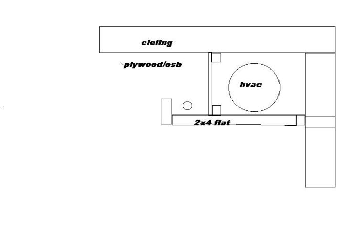

Hey try this, that is if I can attach it. 2x4's at ceiling and wall, plywood ripped to depth of soffit minus 1 1/2. 2x4 stapled/nailed on the flat to bottom of plywood then 2x4 lookouts on the flat. 2x6 or 2x4 band to end of lookouts on edge.

Thanks for the input. Now, how about 2x2's instead of 2x4's, and drywall in place of plywood? Will it do the job?
Hey beamer I'd say sure on the 2x2's, but for strength i'd go with plywood for your hanger. If for any reason a monkey tried to climb on your soffit the drywall may just tear out.
You're right .. I'm with you there for ply for the vertical load-bearing.
I like framing my bulkheads with steel studs.
Either a complete box.....or just an L......with angled supports every so often.
I like the steel studs as I can build and lift most sections by myself. Less weight is better. I'm sure I could get an 18' section up there easily. Set on a removable ledger and screw it tight. Nice and quick.
