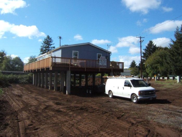

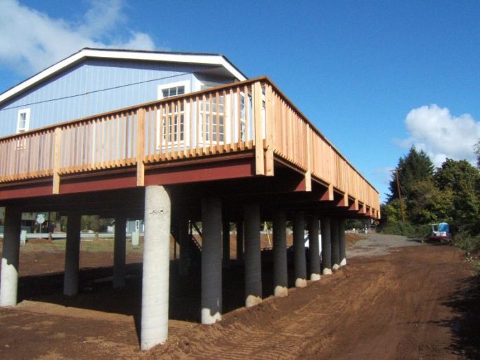

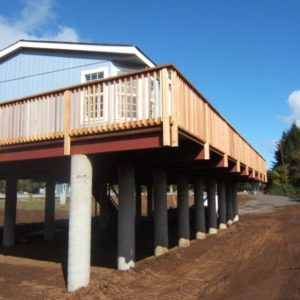

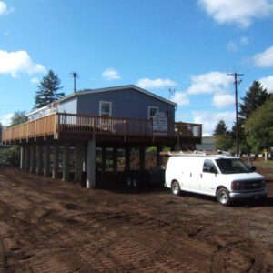

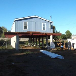

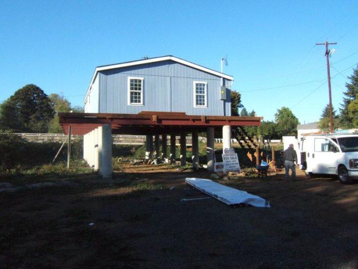

          4. PASSIN | Jun 02, 2006 06:43am | #11
            I know these are really big but i cant figure out how to resize.
            Help anyone?
            Any how the owner is a realistate broker and small developer, he picked up this chunk of land along with some other property up the road. he developed and sold the other parcels and wasnt sure what to do with this peice as it sits in a flood zone.
            He was talking to his engineer and the idea was struck to do what you see in the pics. Its still for sale if anyones interested in packing ther groceries up the stairs!
