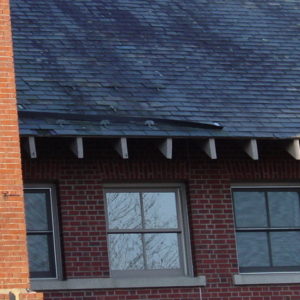

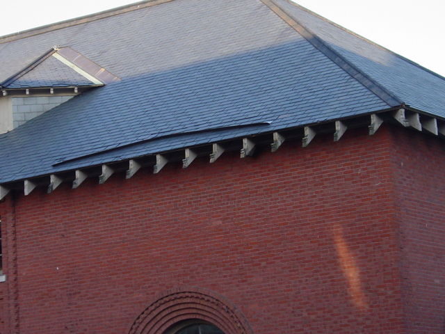

Here’s the building

Our local Masonic Lodge is closing on this property in a month or so . I've booked a 60' articulating lift to look over the whole complex next Sat . I'm going to do my first video appraisal and estimate . It needs a lot of work done to these three connected buildings . Gutters , snow guards , big chimney rebuilt , middle building reslated , etc.
