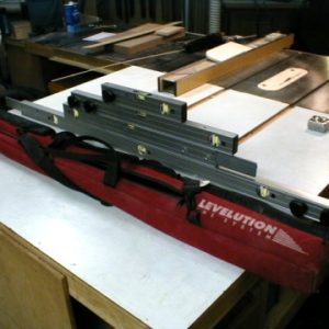

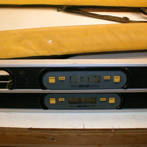

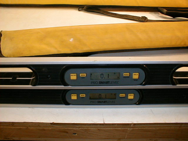

      1. Joe_Fusco | Jun 07, 2003 07:51pm | #14
        Judge it by buying one and using it. I gave away 6 Stabila's after I bought the Levelution.
        I also like my "Smart Levels" too.View Image

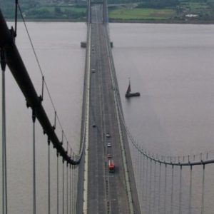

        2. kostello | Jun 08, 2003 01:46pm | #33

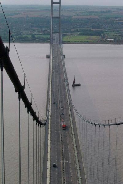

          reason 4 depends on what you're building.
          the humber suspension bridge in the uk has aspan of 1410metres and towers that are 155 metres high.
          the tops of the towers are about 500mm further apart at the top due to the curve of the earth.
          granted I wouldn't want to get up there to check, definately not with a water level
          1. MisterT | Jun 08, 2003 02:42pm | #34
            That far tower looks a little out of plumb, must have been a breeze when they used the plumb bob!Mr T
            Do not try this at home!
          2. kostello | Jun 08, 2003 08:54pm | #39
            should have got a laser!!!!

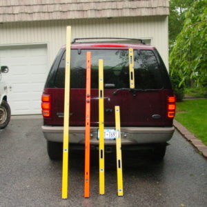

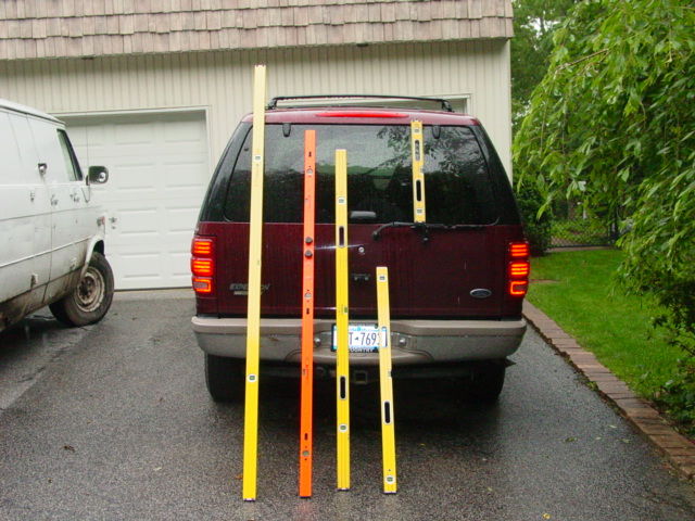

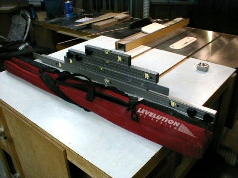

  8. alias | Jun 07, 2003 07:43pm | #13
    just hadto check them all , there all dead on including the levelution(guess which one). checked them w/ a plumb bob and the water level....whew you had me goin' there keep it P.L.S......i hope???/
    1. FastEddie1 | Jun 07, 2003 08:21pm | #17
      What, no torpedo levels?  (You need to use irfanview.)Do it right, or do it twice.
      1. alias | Jun 07, 2003 08:33pm | #20
        LOL... what can i say when i find something i like and depend on i go with it... sometimes to excess . the torpedo is on the job..siding this month with a pergola. i do love that levolution kit .... i've had johnson's ,stanley's ,crick, the stabila was sold to me by a sales guy who brought me out to a parking lot first checking it for plumb and level, he had me throw fifty feet or so in the back parking lot and kick it back to the door walked it back inside checked everything dead nuts... i'm a sucker for a demonstration like this. although i have found variations in them... b
