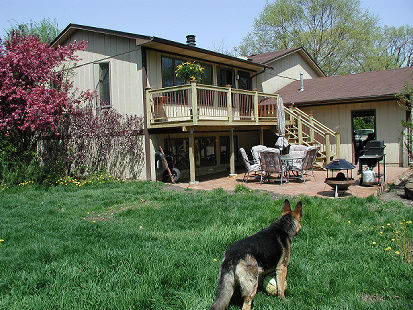

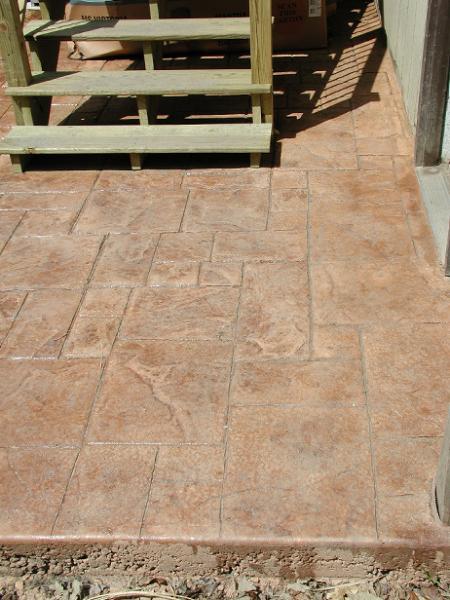

In the picture someone posted above, you can see the sheen of the sealer.

Bill: the problem with not sealing it is not so much surface cracking, it is more the fact that some of the relief effect comes from the contract in color between the concrete (usually colored) and the release powder color; These colors fade if not protected, and the release agent can be worn away completely. The result is a faded mono-tone piece of concrete, that doesn't look anything like what $6 - $9 a square foot buys you. Look at the pic posted above, and then your parents walk.
