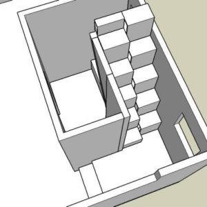

In cooking up a design for a little 340 sf house for one person, I’ve got one of those “stair/ladder” accesses for the loft.  You know, the kind that has treads and risers, is split down the middle, and each side’s riser rise is twice the pitch of the overall.
See the pics.  The stair bears against a sloped wall of 2×4 framing, as can be seen.  The other side of the stringer set is the wall of the shower/tub.
The rise is a little over 9-1/8″ per “step,” but a riser at each side is actually twice that.  The question is, how would one construct the sub-structure for this stair set?
Each tread width is nominally 16 inches, and I was thinking of doing two wallstuds behind each set, with 2x triangular blocks fixed to the studs with sidescabbed 3/8″ plywood, everything glued and screwed.  Sound about right?
If you have built steepies like this, please weigh in here.

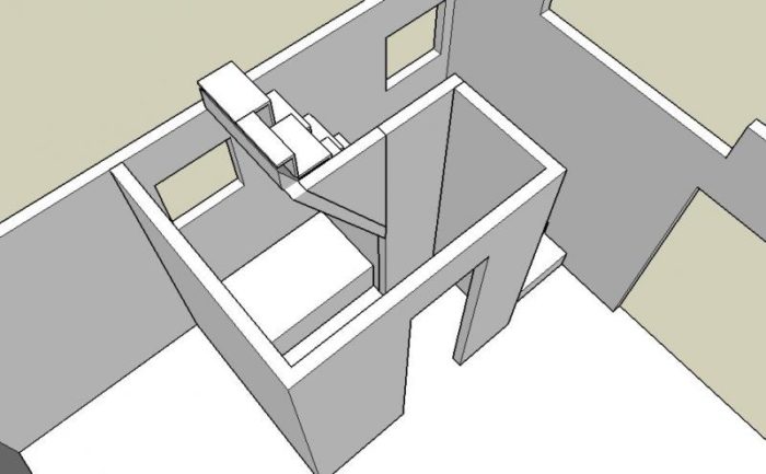

      Gene_Davis | Sep 29, 2006 05:38pm | #7
      Here is a view of my most recent hallucination for how I might build these.
      Keep in mind it is for a rough woodsy little one-man cabin.
      The carriages (stringers) look in the pic as if they are triangles fastened to skewed "studs," but in fact I can saw them one-piece from 14" wide LSL rimboard stock.
      Risers will be 3/4" Advantech material, treads will be 5/4 SYP and have a 1.25" bullnosed lip.
      Where one half-set meets the other in the middle, you will see a section of the carriage at each step.  Everything will be nice and flush there.  I will likely shop-make all parts, and while still in the shop, prep absolutely everything for pocket-screw assembly at the site.  With some glue and all the screws, everything should be tight as a drum.
      On the face side of everything, a few coats of clear polyurethane should make it shine.
