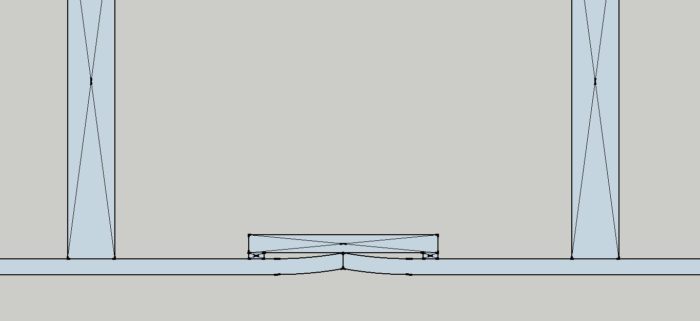

In my opinion, it is not required in new construction, but I would always advise that the rock be hung using butthangers at every end joint. That will contribute much more to flat ceilings.
Butthangers come in various types, or can be site made from sheet stock. The concept is that end joints are landed between joists and not on joists, and the butthangers are used behind the joints to permit the board ends to "suck into" the fastening, thus creating a trough for the drywall compound. Smaller joints, less mud, and flush instead of proud.
Google for "butthanger" and you will end up at some drywall accessory supply sites that show the product and information about installation.
It is worth it. If your contractor refuses, ask him to try it out on your job, and he can be converted. A little extra material cost and a little extra effort, makes for quality joints.
The attached sketch shows a drywall joint in section, and a site-made butthanger splice. The butthanger is a 6" strip of 5/8 plywood or OSB, with side boosters of 3/16" luan, ripped into strips and stapled along the edges. Done correctly, the splice backer, or "butthanger," makes the butt joint recess as shown, allowing for flush mudding of the joint.
