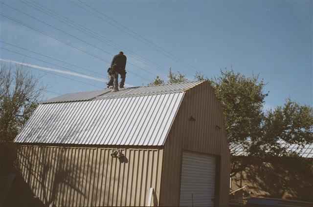

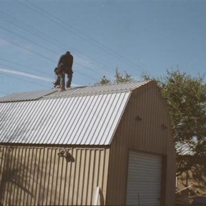

          5. BilljustBill | Mar 11, 2009 01:39am | #18
            I know you have to insure your home for a certain percentage of it's worth, so you have some control as to what the premiums are going to be.
            Part of my consideration of a new roof was metal...at that time, a standing seam was going for over $800 a square...  The problem was that the insurance company has an exclusion about metal roofs.  It's great for reduction of rates because of the fire prevention advantages, but the exclusion had to do with dents.  Even if a brand new metal roof is all dented-up with hail, with the exclusion clause, the insurance company would not replace it and would only consider any slight repairs should there be wind damage or water leakage...  You'd be living with a pretty ratty looking roof for a very long time...unless the hail was jagged enough and softball size to actually beat a hole through the metal....  Here's a shot without rake or corner trims or gutters:
            So, using the Armor Shield II, I still get the insurance deduction just as if it were a metal roof, but if there is really a bad hail storm, the shingles would be replaced as any other asphalt shingle...  Plus, even with $201 a square, it's still not like the cost of a metal roof.  Two of my outside buildings have PBR and UBR-panels that had a 25 yr. paint warranty.  The insurance company allowed $700 a square for replacement, plus added the extra amount needed for new rake trim, corner cap trim, and gutter replacement.
            Just remember, ANYTHING that is said, that means brand names, vent styles, roofing felt weight, ice and water shield upgrades, and promises of discounts....Have it put in writing with specifics.  I even had them give me a certification with a notarized stamp that said all their vendors and employees were paid and no one would be coming back with a lien on my property because they weren't paid...  I know there are some on the forum that were "ticked", as noted in their comments, when I asked about that and when the bid was for 64 squares, but the company only used 51 squares, including 15% waste....instead of letting the bid stand as the company wrongly bid!!  When you are paying out just under $40,000, nobody wants to pay for things that are not used, or have to go back, years later, to deal with a hidden lien on your house because some roofing companies are crooked as a snake...
                Hang in there with getting your new roof.  Don't forget to consider some upgrade in roofing that is affordable, and what shortages of materials or a replacement roof will cost in the coming years...
