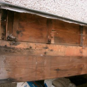

      Here is a picture of the end of the house. It's a small file.
      I usually don't mind banging on a ledger to a set of joists - but this is MY house, and I never want to work for "free" again, on this project, anyway.Quality repairs for your home.

    Aaron, from the photo it looks like the old deck framing was a pretty standard set up. That wasn't a cantilevered deck; in a cantilever set up, the floor joists continue straight out past the beam or foundation wall, which acts like the fulcrum of a 'see-saw'. (I don't particularly like cantilever decks for this reason; when people get rowdy at a barbecue and start jumping around out there, it makes the floor inside the house bounce up and down....)
    You've got a few options, but because the house is finished with parging, you're gonna have trouble flashing the deck properly without doing some demolition and re-parging on the house wall. Assuming you don't want to do that, you are looking at rebuilding it the same way it was built, but (a) using rot-resistant timber, such as hemlock or cedar for the ledger and joists; or (b) caulking the joint between the first deck board and the house and then resigning yourself to maintaining that joint water-tight to prevent a new case of deck rot. As already mentioned, an alternative (c) would be building the deck detached from the house, which means additional footings and sonotubes.

      AaronRosenthal | Jul 29, 2005 09:34am | #7
      Thanks for the help.
      I know about the flashing problem, so I am going to be using PT ledger and Grace joist protectant under flashing. I don't build with PT surface material, I'll be using Pedra (Brazillian Mahogany) for the surface.
      Honestly, since I'm such a nit-picker about structural integrity and solid building, I'm probably going to make the deck detached. Not what I want, but it will outlast the house.Quality repairs for your home.
