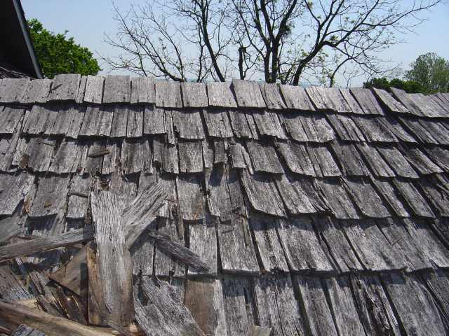

Well, the tear off has begun and as luck would have it..I failed to REALLY look at this roof..I mean, yeah..wood shakes..gonna be hot, messy etc.
What I did not see is that the HO put up these OAK shakes many yrs. ago, with AT LEAST 6 8D and 10D nails each..
I like to use a pitchfork for ripping off cedar..but even with all the rot, it took a ‘tater fork and lots of prying..I mean rusted nails locked to the ply..
The best part so far is the great view, and the fact that I can bill extra for all the sheathing that is shot..there is NO shade, and we are 15 plus degrees above “Normal”..what ever is normal for Central KY in May..
heres some shots of the fuzzy bugger and ya might be able to see the nail pattern in the one pic.
Shingles oughta be here Mon. so for now, just rippen and cussin.

still learnin to LOOK at a roof..shoulda caught the 'problems' with this one , as far as tear off..my bad
About 20 years back, it once took me and a helper 2 1/2 days to do a two car garage roof ( Go-over ). No Lie! I hadn't figured on the topless Go-Go girls layin' down below by the pool. Still don't consider that job a loss.

ah, great minds and all that..I did weld a chunk of 1'' square steel tube to the back of the tines on the diggin fork..just like a roof ripping shovel..after the first attempts.
using a 2' crowbar for pullin the stuck nails ( less bending over)..

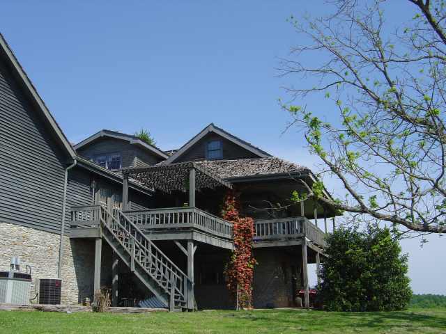

actually a couple of pitches, main house is 10/12, one dormer 3/12 {not good for cedar} another dormer 12/12, and a bridge at 6/12 and an addition at 12/12..
total of 36 sq...just doin the first 16 for now.
found a small mattock like thing in the wifes garden shed,,has 3 tines opposite a hoe blade all cast steel..it has a mediun axe handle and seems to work well too..oh well, I'm still getting off a little over a sq. in 3 hours..handling it off the roof is another story..
Can you just dump the scrap onto a tarp laid on the ground under the eaves and then drag it to a place where you can burn them on site? Lots less carting to do if all you gotta carry away is the burnt-out nails and a few buckets of ash....Dinosaur
