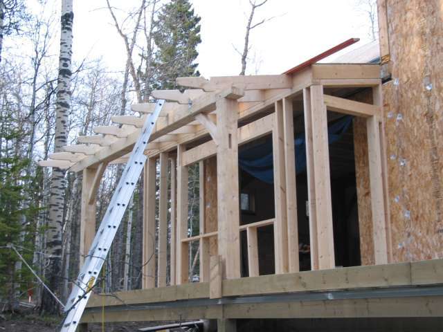

Here's a picture of the porch so far. Still waiting to get the sawmill back so I can cut some more timbers
neat pics. neat house!
I especially don't want to flatten out the bow.. to me some of the magic of working with your own house is you can take the time to do things that you could never afford to have someone else do..
I'm thinking of using the rafters about 24 inches apart at the ends and of course meeting at the top..
