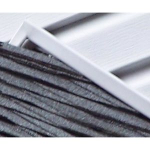

All of the roofing goes to the siding like in this picture: no sign of flashing anywhere, lots of j-channel. What should have been done? What should be done to make it right?
Look here:
http://www.ibacos.com/pubs/RoofFlashingGuidelines.pdf

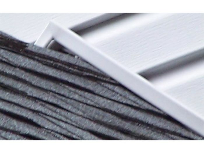

Another picture that shows the roof-siding interface from another perspective.
Yep! You're starting to look for things that will come back to haunt you! Take your putty knife and slide it under the j channel. Pry up and use a flashlight to see what you see. Lift the shingles and look under EVERY SHINGLE to see if there is a step flashing for every course. I doubt that you'll find anything but there might be some. I'd be nervous about all the holes in the flashing through the j channel. Best practice would dictate that the step flashing is tucked under the housewrap. Bob's next test date: 12/10/07
Checked. Sure enough: nothing.

Dave, where you see no step flashing-is this a new roof over sheeting or shingles applied over pre-existing roofing? I'm assuming the house roof was done when the addition was shingled.A Great Place for Information, Comraderie, and a Sucker Punch.
The original shingles were removed before the new roof was laid. Pulled back some of the siding and also looked under the shingles some. Saw no sign of metal.
Yes, and the siding too. Wanted to give the house a consistent look.
Can you get a closer shot (not too close) of the bottom left corner of the second pic - the wall / roof section right at the gutter. I'm trying to see if there is any kick-out flashing, maybe others can see if it's there better than I.
How does this look to you?

That looks like torn Tyvek to me
I just climbed up and took a close look. Not only is it torn Tyvek, you can see exposed wood in the gap. No flashing.
Looked at the section missing flashing with the contractor today. He agreed that the last section(s) of flashing was missing, and agreed to fix it, but was able to show that flashing was in place a few inches further up the roof from where the Tyvek and wood were exposed.
So it looks like the garage roof is mostly flashed next to the main house, but I couldn't tell how far up the wall the flashing went. Plan to check it out tomorrow.
The question remaining is: How many inches up a wall should a piece of step flashing should go? Are there any online references I can show him to back up my claim if there is a problem?

that is insane to install flashing all up a wall but leave it off at the bottom. Let's funel all the water down to one point and then invite it all in at one place!!!!
If it isn't flashed to direct it out over the siding, then it might as well be not flashed at all.
Anyway - I usually use a 4" tall flashing
This mistake has been in plain sight at the entrance to the house for months. He had to have seen it. Maybe he's just hoping I'm not going to notice this stuff.
Thank you.
Step flashing needs to be verified first and foremost.
Then the same flashing detail needs to happen that I described in another reply to you. A piece of flat flashing needs to be slid behind the first piece of step flashing and the bottom of the J, then down onto the snap lock of the nearest piece of siding.
A roof run that big I'd probably use a 2' wide by 4' long piece of aluminum coil stock. That would ensure that the water would fall onto the siding before it ran onto the house wrap.

Step flashing needs to be verified first and foremost. It's verifiably not there.

How's he going to slide step flashing up underneath the j-channel when the j-channel has nails in it. How will the step flashing pass the nails?
Yup. Working out the salvage operation and gearing up for the legal stuff.
There may be nothing seriously wrong. The step flashing may be in there, but the J channel is so tight to the ahingles we can't see it. The biggest concern is the absence of a kickout flashing at the bottom, which will allow water behing the siding.

What CU said. My bet is that the step flashing is under there and that there is nothing wrong with the main part of the roof-wall interface.
Re the bottom corner, again as CU said, there appears to be no kick-out flashing, but it's difficult to really say. Can't see. Need a slightly different viewing angle. Sometime kick-out flashings can be a bit hard to spot - see attached pic.
The other thing is that the bottom end of the J-channel is supposed to be "turned out" which serves a similar function to the kick-out flashing. Probably couldn't see that without actually getting on the roof. Look at fig. 34 on this document, and the text a few bullets above it.
Other than that, the J-channel is technically supposed to be held up off the roof about 1/2 to 1" - according to "the directions" - but with vinyl siding I don't see it as a really big deal.
Got on the roof and checked. No flashing of any kind. The j-mold is jammed hard on top of the shingles and nailed to the top of the Tyvek. It looks like the ice and water shield was used as flashing, from under the shingles to a few inches up the wall.
...there appears to be no kick-out flashing, but it's difficult to really say.
No kick-out flashing either.
...The other thing is that the bottom end of the J-channel is supposed to be "turned out" which serves a similar function to the kick-out flashing. Probably couldn't see that without actually getting on the roof.
Doesn't turn out -- runs straight almost to the end of the roof -- about 2" short, and feeds right into a cut piece of siding.
Doesn't sound good at all....
Hate to say it, but re the no step flashing, that's some really half-a$$ed sheet. Never known a pro who would leave that out. The other items need to be fixed too.
Hold out on the final payment. If he gives you a hard time, check with your state licensing board - if there is one...

Dave, there could be flashing tucked behind the tyvek, but you'll probably have to take it apart a little to see for sure.Steve
