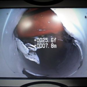

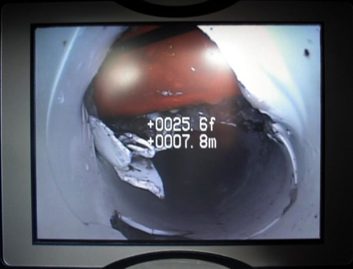

A $728 picture here in NJ. Wouldn’t be bad if I was employed. I know, I’ll get reimbursed. But it’s cash out just the same.
did they use a horizontal borer or a vibratory plow to drag it through there?
I'd be contacting the company that did it ASAP and maybe you won't have to use any of your cash. Have you got in touch with them yet?
I get that it's a picture about 25 feet inside a damaged pipe, but what else are we looking at there?
I think it's the intersection of the OPs pipe and a TelCom Fiber Optic cable.
FIOS = Fiber Optic sumthin or other...
No wonder, and my telephone ain't working... it sounds like sh!t.
I'm not so sure that's a sewer line though. Looks like metal conduit.
I think it's sched. 40 PVC. It's made in white, and will distort like that. And the walls look too thick to be emt. Altho I'll grant ya it looks awful clean for a sewer line....

Maybe the OP will come back and tell us what it is, PVC or metal. The shatter on the bottom wold support the PVC but the edges on the shards don't look plastic but the resolution of the borescope camera could be changing things.
Certainly the damaged pipe is plastic. The cable/pipe is most likely a plastic-jacketed fiber-optic bundle -- I think they are often orange in color and could take on the hue seen in the photo under those lighting conditions.
that's certainly your opnion. wonder if the OP will come back and give more details?
Yeah, I'm kind of curious as to how this problem was found in a clean pipe. Is it new construction and did he just run the camera down there on spec?
The term '$728 picture' makes me think he had to pay for the scope so probably not a luxury for him (based on the fact that I wouldn't pay $728 for a fun picture of a pipe).
Yeah, but the pipe is clean and dry. How was the problem detected?
maybe conduit he couldn't shove/pull his wire through? that's the only idea I have other than clogged sewer but clean & dry puts doubt on that.
I figured I’d give you guys a while to play detective. Here is our, and the rest of the story.
Back in January for the first time in owning this home for 24 years we had our sewer line clog. It happened when we had our daughter and her family of four staying here at our empty nest. OK it happens and our 5 yo granddaughter just flushed a copious amount of TP. Ran to HD and rented the power snake to deal with it.
Then in Feb it happened again. I‘m unemployed so maybe I didn’t do a good job playing plumber and we now have more use of the sewer now that one of us is not working. Did the HD rental again, but noticed how far out I had to snake, which was right about where a FiOS conduit was put in last summer.
Jump to yesterday and it happened again. Three strikes in three months and the details of the rest of the story didn’t take a great detective. So it was time to hire a plumber and document if I had a root or conduit problem. So yeah that is Sch 40 being pierced by a horizontal drill with the fiber optic conduit left in its path. They drilled from the right shattering the plastic leaving the sharp edge dragged to the left side. The cost for the scope was $500 plus they had to snake it first to drain the backup.
And no we are not vegetarians, but the pipe has now been power snaked three times lately.
Anyway, after lurking here for many years, I figured you guys would enjoy a puzzle and the rest of the story as only small contractors would.
Last summer Verizon gave notice they were installing FiOS in the hood for our betterment. The survey company went nuts marking everyone’s lawn with the exception of the sewer lines, which would be hard due to it’s all Sch 40. I was at home for a half day when the guy did this and he was concentrating mostly on his cell phone discussion while walking around with his detector. I’m the original owner of this house and was here often when it was being constructed so I know the layout. I know he was a little sloppy on our natural gas line, and I remember when Comcast put in their line there was a lot of damage in the neighborhood.
A couple days later I came home after work at about 4:00 and in the beginning of our row of 28 homes there is a group of homeowners around with a few contractors, and a NJ Natural Gas service truck. I drive by and down to my house where they are just about to continue drilling. I’m a little nervous about how they are running the horizontal drill over my stamped concrete driveway, so I’m on the front stoop while they drill across my front yard to my neighbor and there is this loud pop. Like teamwork, my neighbors start coming out of their homes and they start yelling to each other if the electricity is out. The guy running the drill yells to his fellow workers that it wasn’t him, as the warning detector never went off. They did two more houses and called it a day.
Total carnage for the day: Up at the start of the street the crowd was there because earlier they pieced an electric feed line and a natural gas line. The police evacuated the surrounding houses. By my house, they severed my neighbor’s underground electric feed, which then blew the transformer on my neighbors yard across the street, and they had done the same up the street with another transformer as well. My neighbor Abby has three young children including a 6 month old and with the severed line she only had one phase feeding in. So JCP&L had to put in some type of phase converter so she could get 220 for her AC during the hot August days until they repaired the line.
A month later Abby is having her front yard dug up due to a sewer issue and found the sewer line center pierced by the FiOS conduit. I also notice two other neighbors this winter had a large amount of ice buildup at their curb, so I guess their sewer line is damaged in some way, maybe not to the point of an obstruction. You can’t hit a bulls eye every time.
So guys, even the big boys can screw up big time even with all the markings.

Sorry, bad wording on my part. That $495 was the additional cost for them to run a camera down the line and videotape it.
27 hours after the call to Verizon, the original contractor Manhattan Contracting, who got replaced during this work, has called asking for the image of the conduit and not to have a plumber come and do the work. They are going to try to get back to me this afternoon. They need to investigate when they did the work. I reminded them about the other failures in the neighborhood and my neighbors situation during their installation. They asked for the neighbors street address to verify.
Not PO'd yet, but getting annoyed after the "we need to see when we did the work since this just started to occur" line. I understand needing the validation part, as no contractor wants to or should need to take up the repair of someone else's problem. But that's why the photo ID. Alhough they did thank me for contacting them (Verizon) before a plumber did the repair.
Tell them that if it's not their cable then you'll remove it.
Yeah I was thinking since it's just conduit with no wire, maybe I should just drag my backhoe up here from the farm, attach it to one of the ends in the junction box and relieve my sewer of the problem.
But they're calling for the marking service, just asked me for all my bills, and should be here on Wed or Thurs. So I'll be here to see how they handle two lines that want to be in the same place. My intent is to have a nice undistorted sewer line straight as an arrow. What they do with a conduit (and how much it stretches) ain't my concern.
You can't tell if there's any fibers in it or not, unless you've observed them enough to know if the fiber was pulled (or if the conduit came pre-fibered).But if they claim they didn't do the deed then it must not be theirs, so they shouldn't object to you cutting it out of the way.
