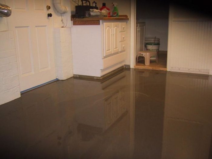

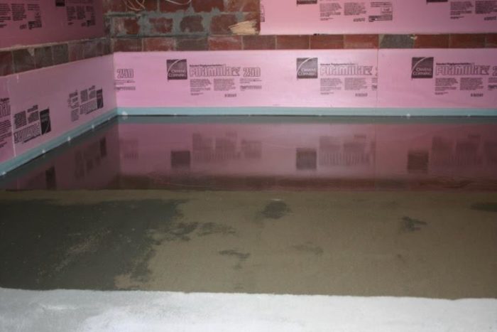

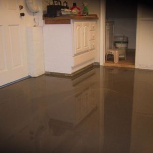

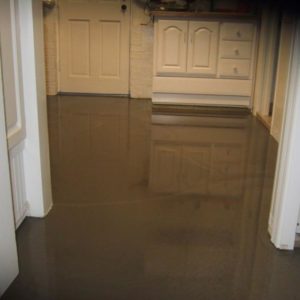

  5. Billy | Jul 18, 2009 03:44am | #9
    If you had used SLC you would not need the Hardibacker.  Why create that extra work for yourself?  SLC is made to be a good substrate for directly bonding thinset and tile.
    HD sells Custom's SLC.  It is good stuff but you need to be ready to move quickly because it sets up fast.
    Check out information over at John Bridge:
    http://www.johnbridge.com/vbulletin/showthread.php?t=1807
    See photos here beginning with post #51:
    http://www.johnbridge.com/vbulletin/showthread.php?t=3710&pp=15&page=4
    I highly recommend the two trash can method -- one for clean water for mixing, and the other for mixing.  I mix two bags of SLC at a time in a trash can and pour.  Mark a line in a clean bucket that represents the amount of water you need for two bags of SLC.  Pour water in the empty trash can, dump in two bags of SLC, mix and pour.  See photos of a couple of my SLC pours below.
    And don't forget to use the SLC primer.
    Billy
    Edited 7/17/2009 8:49 pm ET by Billy
    Edited 7/17/2009 8:50 pm ET by Billy
