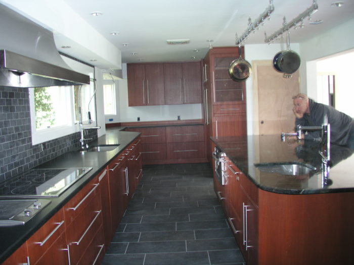

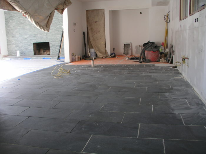

I just finished a 35' long tile floor and kitchen cabinet install among a cherry floor yada yada. In the center of the room I installed a large island so under that I didn't grout at all down the length of a few rows of tile but when I got to the walkway area I used colored sanded caulk.
