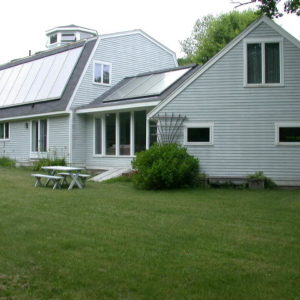

        1. xMikeSmith | Jan 12, 2003 09:22pm | #12
          our house is double walled also...  2x4 exterior with r15 glass & poly vapor barrier.. 1" airspace, 2x3 interior wall with electrical devices and fiberglass r13 batts &  poly vaporbarrier...
          attic is 18" of cellulose with soffit & ridge ventsMike Smith   Rhode Island : Design / Build / Repair / Restore

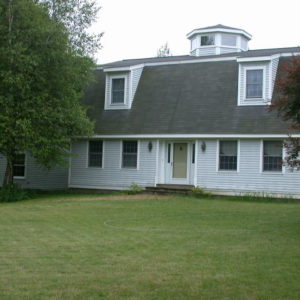

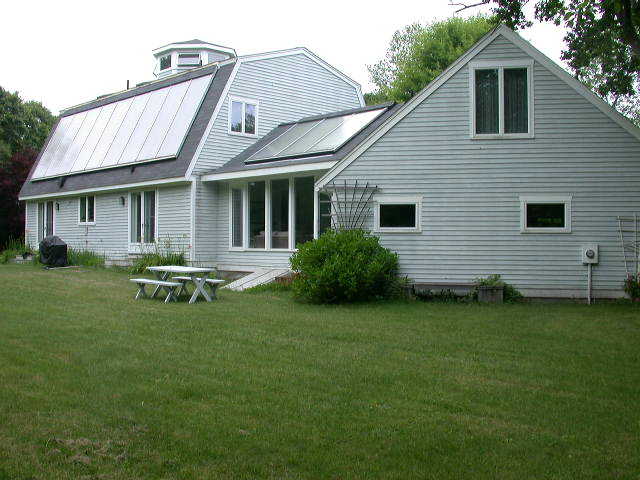

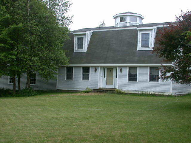

          2. xMikeSmith | Jan 22, 2003 09:32pm | #16
            tim .. here it is.... 18 years later...
            front ....................................................................and back..Mike Smith   Rhode Island : Design / Build / Repair / Restore
