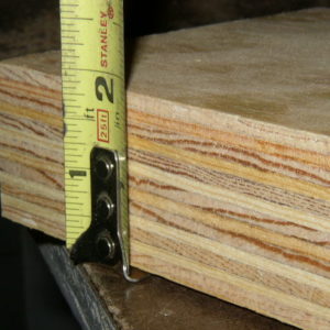

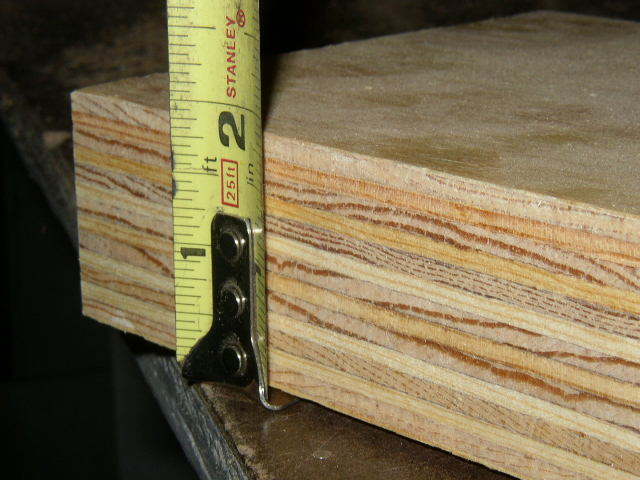

  11. WorkshopJon | Jul 10, 2003 11:32pm | #27
    Haven't seen anybody mention what they thought would be the ultimate for a subfloor. Anybody ever seen something like this used. it's 2" ACX plywood. Pricey but solid.
    Jon
      GoldenWreckedAngle | Jul 11, 2003 12:25am | #28
      Man, strained my back just looking at that picture!Kevin Halliburton

        I'm not a pro, but I am building my own house after the "dry in". I would again use an ICF ( I used Polysteel). Select an experienced contractor for whatever system you choose,because an out of plumb concrete wall is a bitch to hang rock on. At least it was for a dufus like me. Strongly consider PEX plumbing supply lines. There are several manufacturers with websites. Then troll the archives re  discussions of same. The system is great with a centralized manifold to control all faucets, etc. Solid core doors. Flood Saver for washer in laundry room. Bathroom vent fan or fans in attic remote from the grill in the ceiling to keep things quiet. Same with kitchen hood fan. Check the Fantech website. Dual fuel stove lets you cook if the electricity goes out. Gas on top is good, and electric ovens heat more evenly usually. If you have few carpets then install a central vac system. Place the canister reasonably out of the way and it's quiet. Do not put hardwood in the  kitchen unless you don't have kids, and your are OC about cleaning up spills.
      IMERC | Jul 11, 2003 12:54am | #30
      What you do with the other 3/32 of an inch.
      McDill AFB uses 2 layers of that in a lot of their buildings. Steel truss / joists 12" oc, 10' CL spans. 5x10 sheets. AC fir T&G to boot. Aw gawd the work.
      1. WorkshopJon | Jul 11, 2003 01:39am | #32
        IMERC,
        Honestly, I didn't think anyone used it. WOW! Just in my line of work, I come across all sorts of interesting mtrls. Thought I'd share it. It really is heavy. When I here there is some coming in and needs to be ripped, I try to make myself scarce.
        But, for a subfloor. I'll bet it feels almost like walking on concrete.
        Back to work.
        Jon
