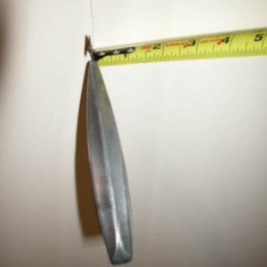

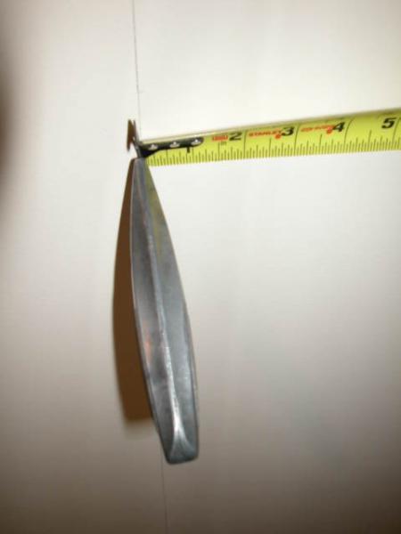

      JeffBuck | Mar 23, 2009 11:49pm | #22
      Instead of a finish nail. sometimes I'll stick my utility knife in the drywall.
      usually measure over 10, 20, 30, 4o or what round number of inches ... stich in the knife ... and hook and pull the tape.

      3. jimAKAblue | Mar 25, 2009 11:48pm | #41
        Good tip Jeff.
        That beats my saw kerf in the drywall idea LOL!
        edit: I do remember pounding the corner of the tape measure into the drywall though if it's hidden.
        Edited 3/25/2009 4:55 pm ET by jimAKAblue
          JeffBuck | Mar 26, 2009 01:29am | #42
          yeah ... a light tap with the hammer will keep it put.
