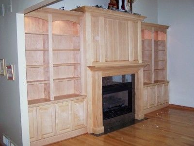

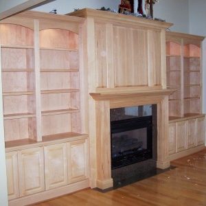

  9. JeffHeath | Oct 12, 2006 07:22am | #20
    Mojo
    Just for inspiration, here's a cabinet job I completed last year out of a maple tree removed from the Lake Forest Academy in Illinois.  You can get some beautiful wood, but it's a lot of work.  This was all milled with a bandsaw mill.  Like others have said, it's a ton of work.  I stickered and restickered it several times, and these boards are HEAVY.  Final result was well worth it.  BTW, I pulled about 10 pounds of nails, spikes, deer stand steps, etc... out of the logs as they were being milled.
    Edited 10/12/2006 12:25 am ET by JeffHeath

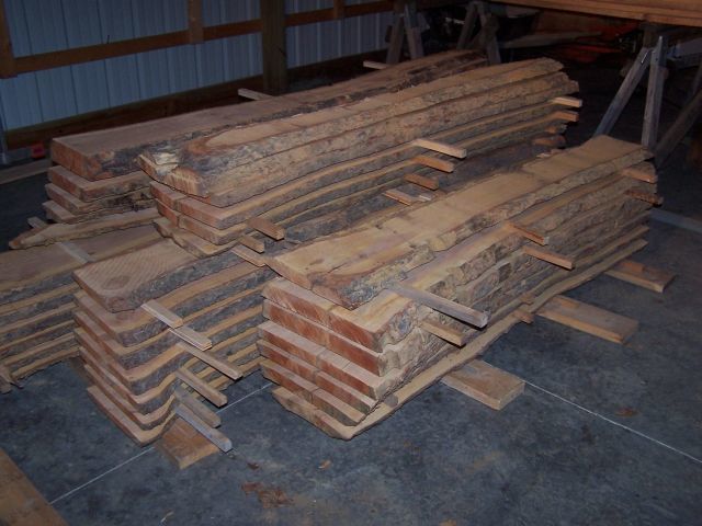

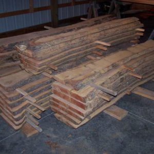

    1. JeffHeath | Oct 12, 2006 07:29am | #21
      Let's try the sticker stack with a slightly more manageable file size.  Sorry to the dial up folks.
    2. mojo | Oct 12, 2006 02:02pm | #22
      Holy cow the finished cabinet is beautiful.  I found a guy with a portable bandsaw who is going to come.  I have some ash trees as well which all have a fungus so I might use those for floor and get some maple boards for a bookcase.  I don't think it will be close to what you've done.  I appreciate all the comments on the amount of work.  This project is for bragging rights so I'll give it a shot and take my time.
      Thanks!

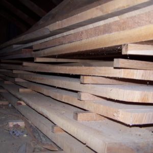

    3. DavidxDoud | Oct 12, 2006 03:22pm | #24
      while it is hard to argue with the beautiful project that is the result of your efforts,  your stickering/stacking job could be better -
      very important to have the sticks directly on top of each other - tho the angle of the picture makes analysis a little ambiguous,  it appears that the stickers wander around a bit -
      but like I said - beautiful project,  thanks for the pictures -
       "there's enough for everyone"

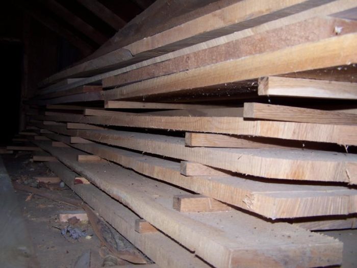

      1. JeffHeath | Oct 12, 2006 04:22pm | #26
        David
        Without a doubt, I agree with you entirely.  These maple logs were my first attempt at milling.  If you look closely, you'll also notice that some of the stickers are red oak, which I know now is a MAJOR no-no.  The tannic acid stains the wood pretty well.  Since then, I've learned alot about milling, and have about 8000 board feet of logs I milled myself in my wood shed.  My main business is concrete, but my secondary business, and passion in life, is woodworking (next to my family, of course.)
        I now stack all the stickers vertically.  Here's a pic of some cherry logs I milled 2 years ago, with a much better example of how to do it correctly.

    6 months air dry
    A month or two at the planing mills kiln - they then ran everything through their moulder @ .20/lft iirc.
    There was a coolness factor involved, but the floor was still relatively inexpensive, and the wider random width boards (full length of the room) made the kitchen look great.
