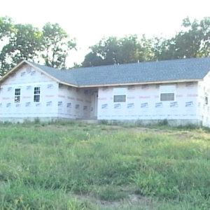

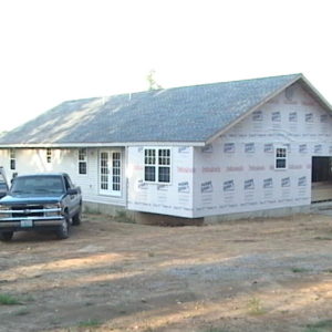

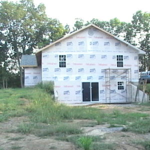

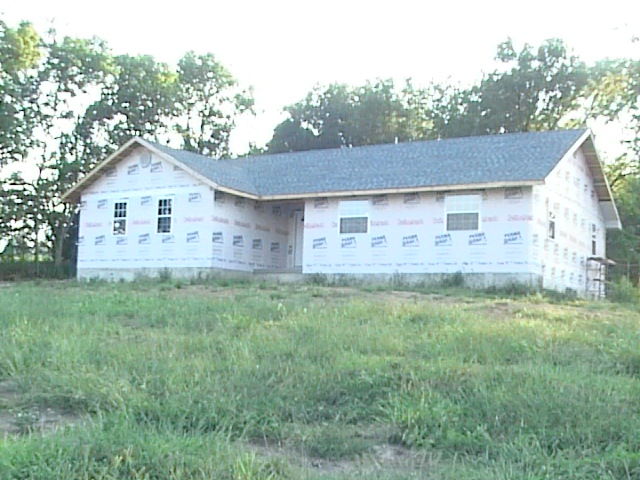

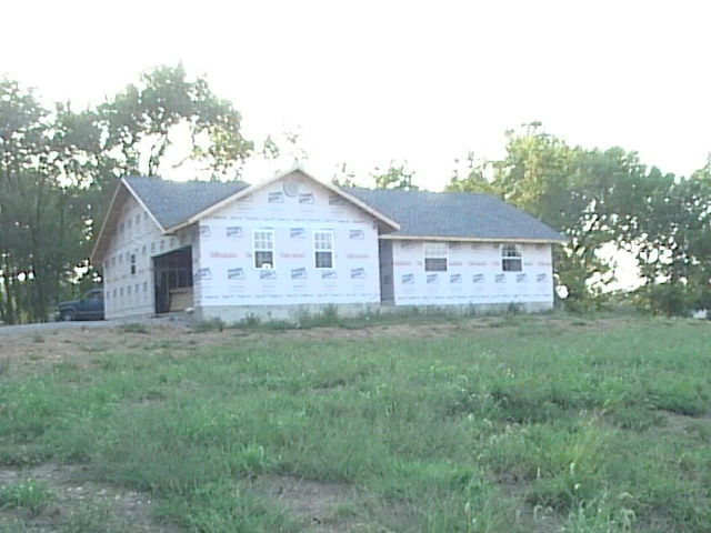

Hi, guys sorry its been awhile getting back here to talk to everyone!!!!!
I have been busy keeping eveyong here at home happy like my customers, brother in law that Im helping with this house and wife and kids. So I haven’t really keep up very good on my pics but this is the newest ones for eveyone to see.

    Looks good,  when do mechaicals get roughed in?
    I'm only half as dumb as I look.
    1. fab4beck | Aug 26, 2006 04:00am | #8
      It's going good as far as I can tell!
      We are getting all of the outside done when weather is good, but on the rainy days we have been doing the electrical rough in since we placed all of the boxes in to figure out the places where the outside lights and outlets will be so we could work our siding around them. If you noticed in the pics the back side of the house has gotten some of the siding on it, but it is kinda hard to see it since it is gray and blends in with the house wrap on the pics.

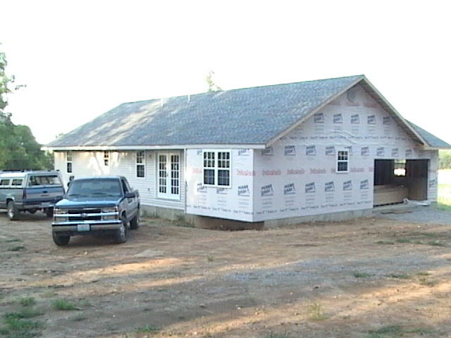

    Looks good, except--why for did you put the garage door right under where the roof valley terminates?--seems like a concentrated load right in over the door header. Is it my imagination, or does the header curve downward ? IMO, it would have looked better to move the door to the left (Maybe you can't) or to have done something different with the roof there. Hey, everyone's a critic!

      Ease up fellas.  It was his first time "building a house".  As in he actually built it.  Didn't design it.  Didn't GC it.  Didn't spec materials for it.  He framed it.  And he should be proud of himself.  Some of us still think that "building a house" actually involves banging a few nails.View Image

        House looks fine, and I agree he's doing a good job.
        I don't know what the background is on this, there must have been another post somewhere.
        I was commenting on the lack of windows. If it were his house the comment is directed at him, I guess it his BIL's house so it's not his choice.
        Either way, it's going to be pretty dark in there.

      This was a package house and we built it according to the drawing except the garage door my brother in law wanted to relocate since his driveway was going to be off to the side. The door almost has to be right were because when the concrete contractor poured the foundation and pads that is were the opening was put in the concrete.

      1. Danno | Aug 26, 2006 03:22pm | #15
        Ah. That explains it. That's why I hate it when the customer makes a change, but doesn't think through all the possible ramifications.

  3. joeh | Aug 25, 2006 06:01pm | #3
    Another critic, was the window budget last on the list?

      No budget on the windows.It was package deal, plans, lumber, siding, roof, etc. Depending on the package I think that you can get all materials ready to move into, except for HVAC.But I could not ID the model, but it looks like the caochlight, but with the garage door moved. But there are some other differences.http://www.sutherlands.com/coachlight.htm
      1. fab4beck | Aug 26, 2006 04:17am | #12
        You pretty much nailed it on the head but some extra windows were added that weren't in the plans. Yes it is the coachlight package. Thanks for watching out for me Bill!

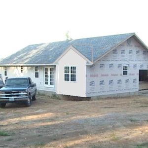

    Was the rear bumpout part of the plans?  I'm not in love with the way the roof does a zero overhang there.
    1. fab4beck | Aug 26, 2006 04:16am | #11
      Yes the bump out was in the original drawing. We thought at first the trusses were wrong but looking further at the drawing made me think we built the bumpout wall wrong it actually needed to be shortened and a header added across the diningroom to let the trusses go in further to line up with the other trusses.
      I have seen plenty of house built very simalar with a bump out on them and the roof ending at the wall plus it will have a gutter there to catch the run off so it shouldn't hit the window.

      "Was the rear bumpout part of the plans? I'm not in love with the way the roof does a zero overhang there."He changed it for you.....Joe Carola

        1. Framer | Aug 27, 2006 10:58pm | #23
          "Thats cool wish we would have thought of that sooner, LOL."It's not to late. I add those on all the time to houses like yours.Joe Carola
          1. fab4beck | Aug 28, 2006 04:24am | #24
            Nice thought but I don't think Brother in law would be willing to go back and redo that now!
