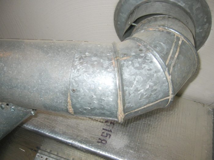

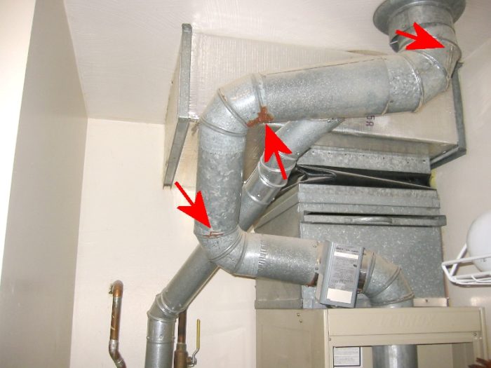

The best way to tell is with a draft gauge and visual inspection (if you know what to look for.) Smoke can give a rough idea, but check for rust and dirt under the drafthood (aka bonnet) and for rust at the flue connections.

I've attached a couple pics of the sort of rust to look for - they're from a furnace I looked at today, but the issues are very similar.
