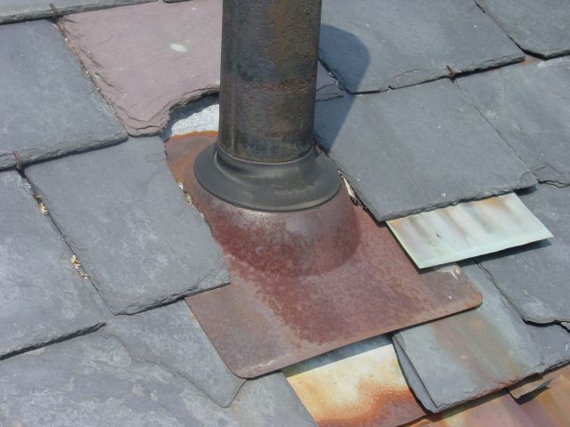

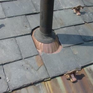

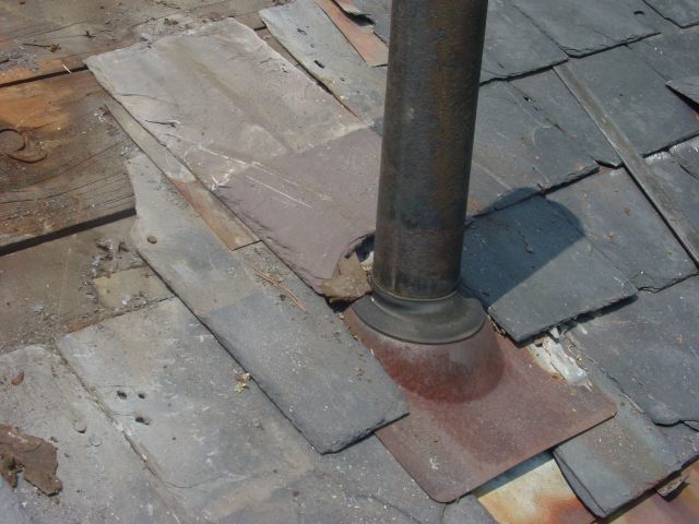

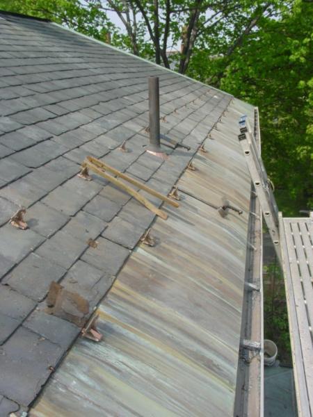

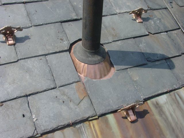

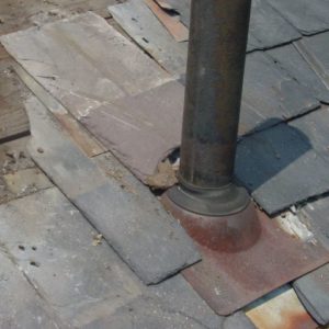

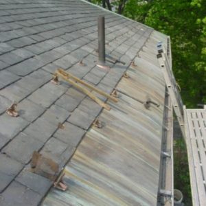

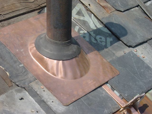

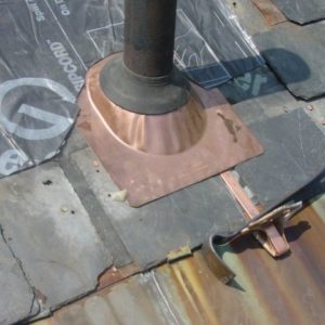

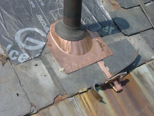

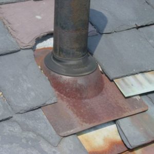

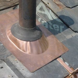

Thought some folks might like to see a vent stack install in slate and snow guards to retain snow and ice.

  2. DanH | Jun 03, 2007 01:10am | #2
    I've never looked much at slate roofs -- you don't see much of it around here. Is that metal (I presume) bottom edge normal for a slate installation?
    1. theslateman | Jun 04, 2007 02:57am | #9
      Dan,
      Yes, having a copper "apron" is quite common here in Maine. Prior to our Global Warming trend - we used to get lots of snow here, and the apron was a non permeable area where snow and ice could do no harm to the inside.
  3. DanH | Jun 03, 2007 01:13am | #3
    Also, I see that the original vent jack is a rubber gasket model vs a lead collar, suggesting that it's no more than about 30 years old. Is that true, or am I missing something? I'd think that a slate roof should be good, with minor repairs, for 50 years or so.

    2. theslateman | Jun 04, 2007 03:02am | #10
      Dan,
      Yes that boot was put on when the aprons were put on ,maybe 15- 20 years ago. Not by me but I remember when that house had work done on it.
      Slate can certainly last in excess of 50 years,some more like 100- 150.
      If you look at another thread of mine here " working on my own place" the salvage slate I'm using is close to 100 years old and the install I'm doing is geared for another 80 to 100.
    Matt | Jun 03, 2007 03:23am | #6
    OK - how about you explain to a southern boy about the the purpose of the snow guards and the metal all along the eves.
    1. DanH | Jun 03, 2007 04:03am | #7
      The snow guards are to keep the snow/ice from suddenly sliding off the relatively slippery slate. This can create a hazard for people and things below. Same things are commonly installed on metal roofs, at least above doorways.The snow guards may also help protect the slate from damage due to suddenly departing ice, but that's just a supposition.Dunno about the metal, unless it's old-fashioned ice shield, given that ice dams are apt to form along the edge in old, poorly insulated homes, and the slate offers very little resistance to pooled water from an ice dam.
      1. theslateman | Jun 04, 2007 03:08am | #11
        Matt,
        Dan has nailed it just right. The snow guards ensure that the paper boy, mailman, and oil delivery person all get to go home the night of a Winter delivery to this home.
        Cascading snow and ice off a slate roof can really be a frightening experience if you're below.  Shrubbery, plantings, etc. also do better without huge snowslides onto them.
        Walter
  5. MikeCallahan | Jun 05, 2007 03:45am | #13
    Here in the Sierras we often get over 5' of snow piled up on our roofs. No self respecting plumber around here would daylight the vent stack anywhere but just below the ridge. It will prevent the vent from getting sheared off when the slab cuts loose. The "snow guards" will also shear off, making an ugly mess. They are only a band aid and not a permanent solution. Snow guards are only designed for light loads. They are proven to be a bad idea and no one uses them unless ill advised.
    Mike Callahan, Lake Tahoe, Ca.
    1. DanH | Jun 05, 2007 06:38am | #14
      Yeah, this is typical of how conditions differ for such things from one area to the next. In our neck of the woods you'd be foolish to NOT have them, from a liability standpoint if nothing else.
