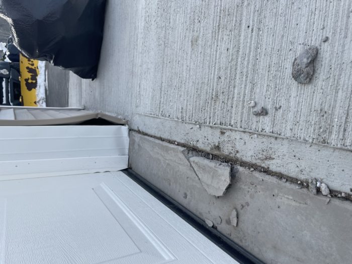

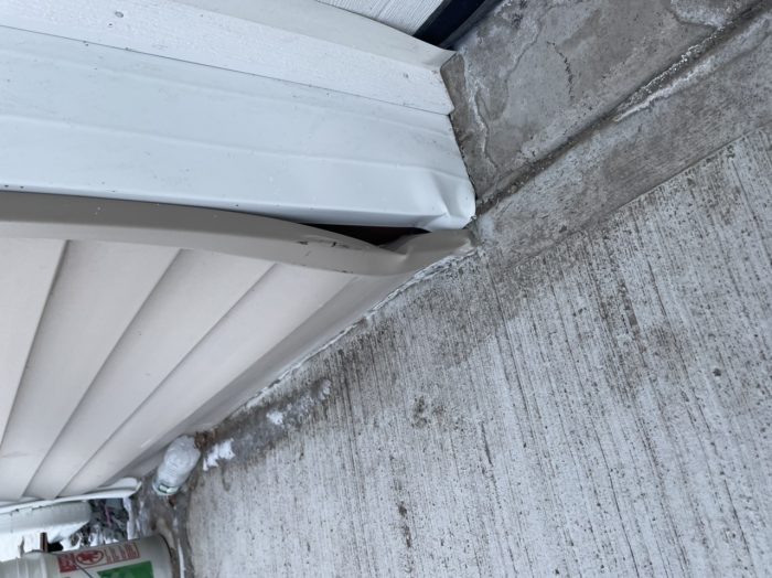

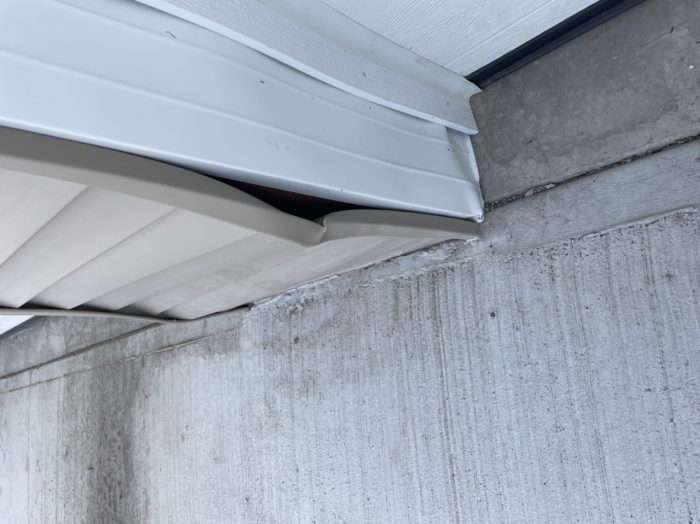

We had a garage addition built 10 months ago , used icf blocks , and had a section of asphalt removed in front of garage doors and they pourd a slab bumping up to garage , it looks like the ground froze and the concrete rose and is buckling the siding , and also cracked a little bit of the concrete , was this preventable ? It looks like they pourd the concrete right up against the siding and even left some siding under the concrete , curious if this could of been prevented

    If the damage was in fact caused by frost heaving, I think a few inches of compacted drain rock under the slab and a perimeter drain (depending on slope and waterflow) would have prevented this damage.
  2. andy_engel | Feb 02, 2022 06:18am | #2
    Yeah, in a couple of different ways. As the previous poster suggested, better drainage below the concrete. Or not butting the siding directly to the ground - Why was that done? Is there no stem wall?
