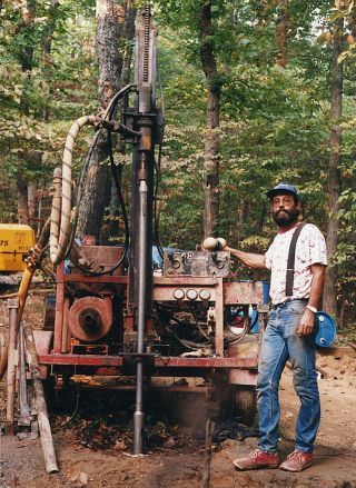

Big back yard here. Not even close to filled. Got the motor grader to turn over yesterday, relay'd died. The not-yet crushed Aerostar had one. Maybe I'll let it sit awhile longer. Sure beats a trip to town.
Tomorrow I'll clean the grader points and get fresh gas when I go get seed potatoes. Varoom! Winter's finished, time to get stone on the other 1/2 mile driveway. Verizon's still interested in a tower.

<<My first bore hit a 5' void, not supposed to be any on this side of the Blue Ridge. Not knowing better, I eased to the bottom and kept going. Wasn't long before my bit was stuck.>>What's that mean? Limestone cave or...? I'm trying to understand why you can't just drill on through. What a cute little rig! I'd be drilling holes all over if that were mine!I'm kind of going the other direction these days from ownership. Someone quoted me $600 to replace my differential years ago. I wasn't sure what a differential was, but i didn't have $600 (or a lift, which would've been handy) so i got a book, pulled the axles, read a couple more pages, took out some more bolts, then removed the differential. I wiggled out with the thing wedged in my chest and then did everything in reverse. Now i know a mechanic who specializes in Toyotas and has all the tools that would have made that an hour-long job instead of the two days it took me.Back pain...this isn't lower back pain from lifting, but my guess is nerves were crushed when the stairstep edge dug into my middle back. I've been googling it and read a term called "electric-shock pain" to describe the referred pain from the spine to the hip area. Good descriptor: it's immediate, immense, and there's no build-up to it so that one can steel oneself. The mental reaction is incredulity, like having someone sneak up behind and toss a big bucket of ice water over your head.Life is also immeasurably better since my college roommate (1975!) just visited this afternoon with two grocery bags full of fruit, several salads, and an Easter basket full of Dove chocolate. I tried to make her tea and ended up starting a kitchen fire that she helped me put out and vacuumed up the box of soda i threw at it. What a sport!
Limestone over the Blue Ridge, not here. I've got schist. Not supposed to be voids. Oldest through road in this part of Va going by, so maybe it's an old shaft. No telling. All I know is it was 65' down. No sign of a mine, I looked.
As the drillers say "when you lose your air, pull out". Lose your air, as in don't have it coming back up your bore at you. Allows cuttings to build up around where you went on down through the void floor. Eventually the pile collapses, trapping whatever's there. Drill stem in my case, and I hadn't yet heard anybody say that.
Common wisdom when stuck is to pull- really hard. Often resulting in losing the hammer and bit and whatever length of stems. Several thousand dollars worth.
Deep Rock, who built my rig, told me to avoid that by flushing the bore with water until it comes clean. I've got 2 engines, one drives a hydraulic pump, the other a trash pump. I ran 3/4" steel pipe down the bore and flushed. Worked great (after I hauled a couple hundred gallons of water up here).

My little rig has everything miniaturized. Stems are 5' long, lots of screwing/unscrewing (hydraulically). But that makes it simple for solo operation, nothing's very heavy. Bore is small, reservoir very small. Trailer's small enough to be towed by anything.
I once considered offering stuck bit service to the half million dollar rigs, but figured that once I taught them the technique they wouldn't need me for anything. So I settled for telling the ones I knew how well it worked. Don't know if they ever tried it.
This rig was designed for not-rock drilling. The pump was to water-flush the cuttings. Probably'd work fine in tidewater. Here, there's no bore without a hammer. Hammers require air. I have to rent a large trailered compressor to make it all work. We're required to case to solid rock and that's the end of the casing. Everybody I know uses pvc.
Over-sized "soil" bit to bedrock, leaving a void around the casing. No pounding, just drop it in. Then pour the bentonite beads around the casing. When I originally asked, the health dept said casing to rock. Great, 4-14" here. No... minimum 20'. I got 30' before I had to switch to the hammer drill.

Only one of the options I considered here. Resulting in my purchase of that small drilling rig.PAHS Designer/Builder- Bury it!
