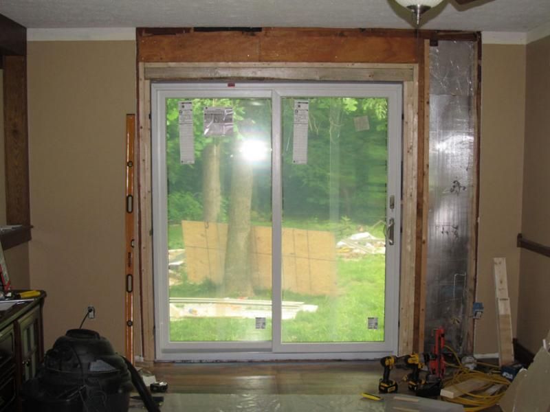

We have door!
Putting the frame together was no problem at all... certainly not worth paying an extra $250 and waiting 4-6 weeks. Lots of work inside and out yet to do; but the door is in, secure, and functions well. The view will get even better once the protective film is off the glass... and once all of the construction junk is out of the backyard.
straw
Looks good-cept for the giant step.
Hope you detailed the sides and bottom, those are important locations to pay attention to.
How's the wife like it?

Oh, and to answer the above, we're both very happy with the result. I'll ultimately do something about the drop down. Might be as easy as a step leading down to some pavers; or a small (12x12 or so) deck. We'll see where budget and motivation are both at when the time comes. Besides adding a receptacle and a light outside of that area, I don't intend to devote anymore resources to it until the garage is done.

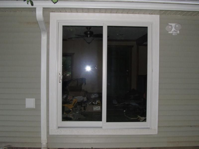

In case anyone has been lying awake at night waiting for closure on this project: here are some finished shots. Added the outside security light and "rain proof while in use" double outlet (GFCI that then feeds another outlet so they're both protected) a couple of weeks ago; and then did the interior trim today. Maybe I just don't remember since it's been a couple of years since I've bought any; but it seems like the cost of oak has gone up.
Only thing left to do is my least favorite part... cleaning up. Thanks again to everyone for your help!

looks good.
Don't forget the step.
"Don't forget the
"Don't forget the step."
He'll only forget it once.
Don't worry, some kind of safe transition to the yard will be put into place: either a couple of steps or a small deck. We'll have to excavate by the foundation there to underpin the footer since there will be a rather large point load in that area when the garage is built. And also, once the garage is done, I'll be having the propane tank moved to a different spot in the yard that will require trenching through that area to hook a new line up. Don't want to do anything "permanent" until those two things are done; and I don't want a sloppy temporary solution that ends up becoming permanent just because it's already there. The door will just serve as a really large window until the garage is done.
