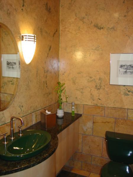

Here's our powder room ...
That is one gorgeous room, sir. You've redefined "old world look".

Thanx.
When I did a lot of trim work as a sub, I worked for an architect/builder who always did a powder room pretty out of character for the rest of the house, usually around some theme.
I tried the same here; house is fairly contemporary, and I mixed some contemporary elements with a slate floor, travertine border and wainscoting, and the faux old world plaster thing. I like the result, and it's gotten a lot of ooh's and aah's from spectators.

The powder room was kinda my baby. I put all sorts of blocking in the wall and then framed out the vanity in 2x4's and 3/4 ply, all glued together and lagged to the blocking. You can't see from the pic, but the vanity is only 20" from the top down, then open underneath. Had to build it strong to carry the slab plus any pounding it might receive if someone wants to dance on it or get lucky, or whatever.
Walls are primed, then a brushed-on coat of pumpkin colored latex, then dark green glaze brushed on solid, then most of the glaze rubbed back off, then a thinned brown glaze sponged on then ragged off, then a brushed coat of Deft to seal it all. Heavy brush marks add a lot to the look.
