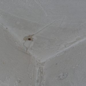

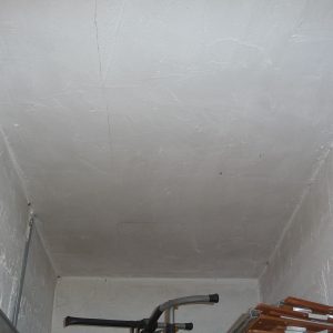

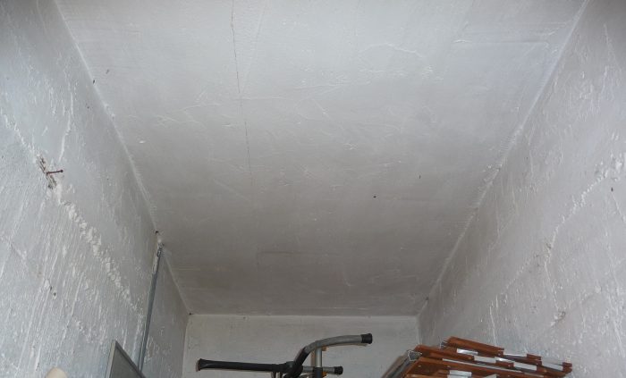

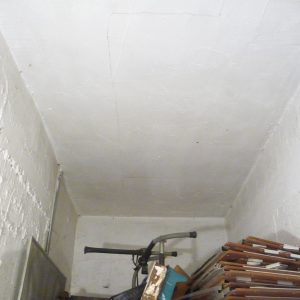

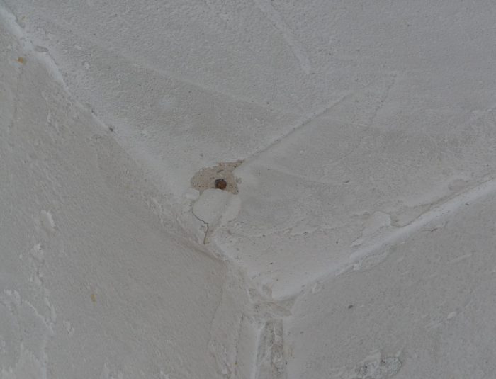

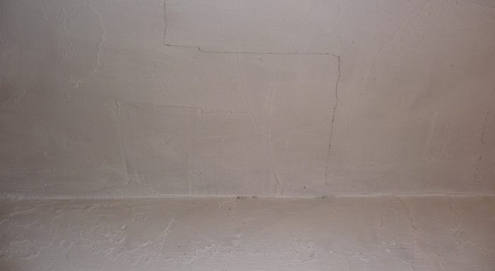

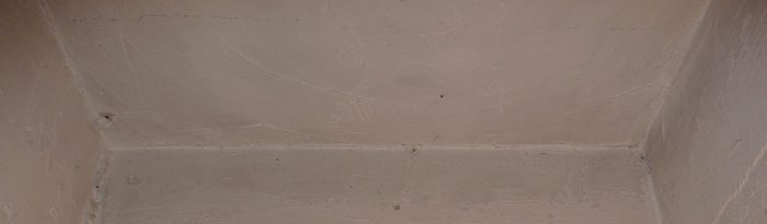

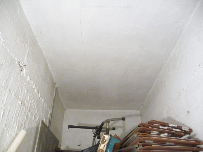

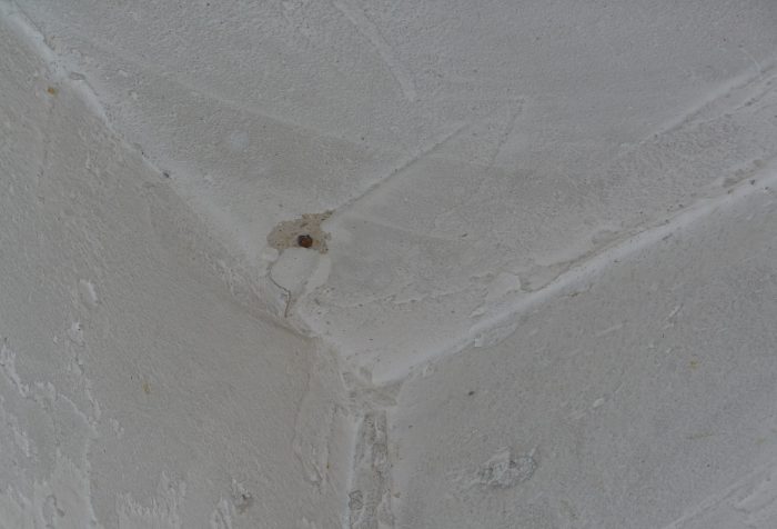

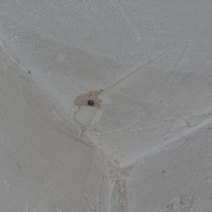

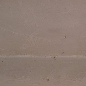

  3. yCElme | Jun 16, 2021 07:07pm | #3
    Here are some images.

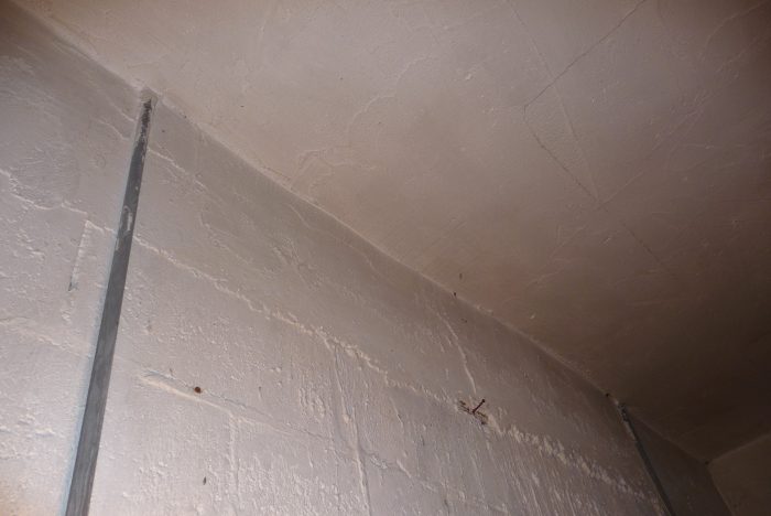

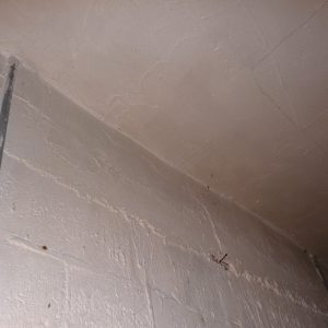

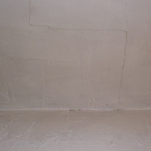

  4. yCElme | Jun 16, 2021 07:08pm | #4
    These two images show a hole in the ceiling and it looks like concrete is exposed but not sure.
  5. nomorecoffee | Jun 16, 2021 11:31pm | #6
    Rock lath plaster. Can tell by the texture and that zig-zag cracking and the era is about right. I have this stuff all over my house. Thinner 2'x4' gypsum panels go up, rough plaster coat goes on, finished with smooth plaster coat.
    You can put anchors into it but it won't hold real heavy stuff. Get a good stud detector, find the joists, and fasten into the joists through the plaster. Only thing is it COULD have been put on over strapping but that might be a new england thing and not something they did in florida.
  6. fsmyles | Jun 17, 2021 07:14pm | #7
    Ceiling looks like it was parged with a cement based material over 2' x 4' or 8' panels. Not structural so not a good idea to hang anything from it alone. Locate the joists using a stud finder, magnet (to find nail pattern) or 1/4" masonry bit (drilling in a 1" schedule). Screw hangers or a 2x into the joists.
