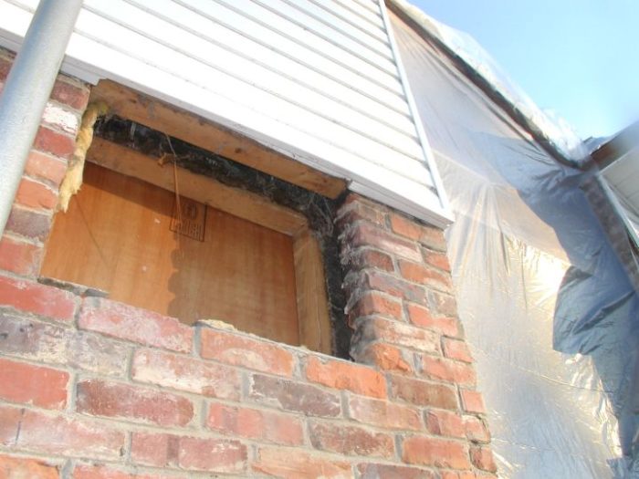

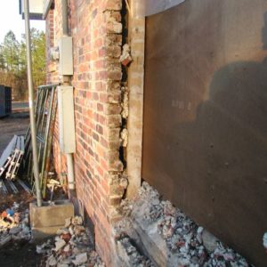

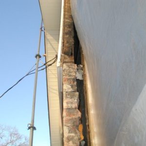

Ok, I’ve removed the chimney and now discovered that a false wall is sitting atop the brick wall that abutted the chimney on each side (the pic where the AC unit was located shows a fairly good view of what I’m talking about). The extra framing apparently serves as the support structure for a facade that provides a flush consistency for the exterior extending up to the gable. I’m not quite sure how to deal with this “additional wall” since I don’t like the brick on this house and plan to deal with it as part of the remodel. I’m determined to either:
– Remove the old bricks and install a different brick
– Brick over the existing bricks with another layer of bricks
– Or just cover the bricks with vinyl siding.
(Paint or stucco have already been suggested, but I don’t care for either of those ideas.)
Anyway, since I’ve got that false wall sitting up there, and on the opposite end of the house as well, I’m just not sure which of the above options I should pursue. I’ve provided some pics for your scrutiny…and viewing entertainment. I’d love to hear your thoughts on it.

  1. RalphWicklund | Jan 26, 2007 05:54am | #1
    Well, if you don't like the brick...
    Fill up that dumpster.
    Then you can determine what you are determined to do.
    New brick up to the build out. Or,
    Rip out the facade, too, and prep for Hardie lap siding all the way up.
    Matt | Jan 26, 2007 08:25am | #2
    You said:
    - Remove the old bricks and install a different brick
    - Brick over the existing bricks with another layer of bricks
    - Or just cover the bricks with vinyl siding.
    Option 1 would work.    I think you will find that that is quite a bit of weight if you have to pay by the ton at the landfill.  Also, I guess you would have to go all the way down to slightly below grade.  Is it a block foundation?  Might be a bit hard to peal the brick veneer off the block - there may be ladder wire or similar in there.
    option 2 would work only if you want to give up ~4" in width of the roof eve overhang.  You would not have to deal with getting rid of the old brick though.
    option 3, you should probably leave a foot or so showing of the old brick just above grade.
    BTW - sometimes catchy titles for threads can be entertaining, but other times you might as well just leave the title blank or maybe even give it a meaningful title... yea I know, I'm no fun... :-)
    Also: my guess is that the false wall is not supporting any weight.  It likely may have even been cantilevered out and then the brick veneer added in under it.
