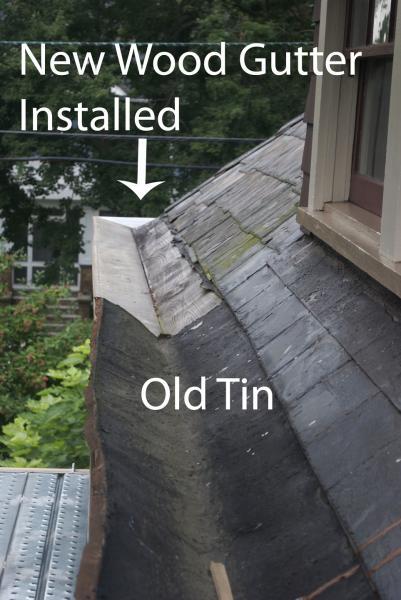

What to do with this part of the roof?
pixelfixel | Posted in General Discussion on July 29, 2009 04:41am
Finally ready for roof. I’ve had one roofer come out who says he’s thinking modified bitumen might be best for this part of the roof. We both know copper would be best, but I don’t think I can afford that. Any other ideas/suggestions? I believe he said he would put down 2 layers. of the modified bitumen.
Also going to have him install 4″ round downtubes. Possibly 5. There were originally only 3.
Thanks for your help.
Jim
http://foursquarerestoration.blogspot.com/

        There are several threads on box gutter lining in the photo gallery. That's a fairly simple gutter. Bending should not be that difficult. Soldering the joints is the tricky part. All sides should be pre-tinned prior to soldering. Copper is fairly cheap right now. If you're not afraid to try it, we can help talk you through it.http://www.quittintime.com/      View Image

          Thanks much. I don't know the 1st. thing about installing it, but I'll take a look at some of the pics that you suggested. I appreciate the help! Jim
          pixelfixel | Jul 31, 2009 07:35pm | #14
          Thanks again seeyou. I was able to find some pics of galvanized that was done. If I were to do this sort of thing, would I buy the galvanized or copper by the sheet or roll? Also, I assume I would need some sort of bending machine to get the correct V pattern right? It looks like I should bend it to match the built in gutter, rivet it and then solder it with one of those irons. Is that the idea? Also pre-tinning as you suggested.I was thinking about how to do corners and it makes my head hurt.Jim

          2. seeyou | Jul 31, 2009 08:25pm | #16
            Probably by the sheet. It's rare that the total girth of a built in gutter is less than 24", which is typically the widest roll stock available. You'll also have to buy 50' rolls which is a problem if you have 105' of gutter to line. Sheet stock is usually available in 8' and 10' lengths, so you can minimize your waste.
            Most rental places rent portable siding brakes.
            After you bend your piece to fit, lay it in the gutter and slide it as close to the corner as you can while it still lays in place. Measure the distance between the outside corner of the gutter and the outside edge of your liner piece. Note that measurement and move across the miter measuring back that same amount at each bend. Connect the dots and cut an inch or so to the outside of the line and fold that inch thru the miter. Do the same from the other side and you'll have a good overlap to solder or rivet.
            Walter and I will try to talk you through it. We have slightly different methods, but we'll get on the same page.  http://www.quittintime.com/      View Image

          6. theslateman | Aug 01, 2009 11:39am | #22
            You're doing great . I can't think of anything else except to pad the new gutters when they rip off the slate roof later on , to avoid punctures .

            pixelfixel | Aug 09, 2009 02:47pm | #27
            Thanks. I've been thinking a lot about this roof and what will be my next step. It looks as though I'll be doing the built in in Copper. My wife wants to keep our slate roof which should be replaced saying we simply can't afford the $20,000 to replace with the 50 yr. shingles. I'm thinking I'll try my hand at replacing some of the broken slate myself and then remove the lower row of slate so I can install this copper underneath it. I assume that's how it's done? Hoping I might get another 15yrs-20 yrs. out of this slate roof, but I just don't know. The back of the house is the worst spot since it gets the most sun, but it doesn't leak. So far the roof only leaks in one spot which I have to get to to see how it's getting in.If I do go this route, I was thinking of possibly using copper ridges on the roof. What do you think of those? http://josephjenkins.com/store/home.php?cat=341Thanks again.

          10. theslateman | Aug 10, 2009 02:11pm | #28
            Jim,
            I'd want to see more pictures of the slate roof before I gave more advice on whether repairing is an option .
            Even if you left the roof in place and just relined the gutters you would need quite a few starter slates and full pieces to replace those that are or will break during removal .
            Do you have access to salvage slates?
            I wouldn't bother with copper caps on that roof just yet .

          11. theslateman | Aug 11, 2009 09:43pm | #29
            Jim,
            I just went into your blog to look at some other roof pictures .
            That roof is very tired soft Penn . slate that is worn out . You might nurse it thru another 10 years , but I think that would be unlikely.
            20 grand to strip and roof sounds high to me for that roof .  Have you gotten a second price or just the one ?
